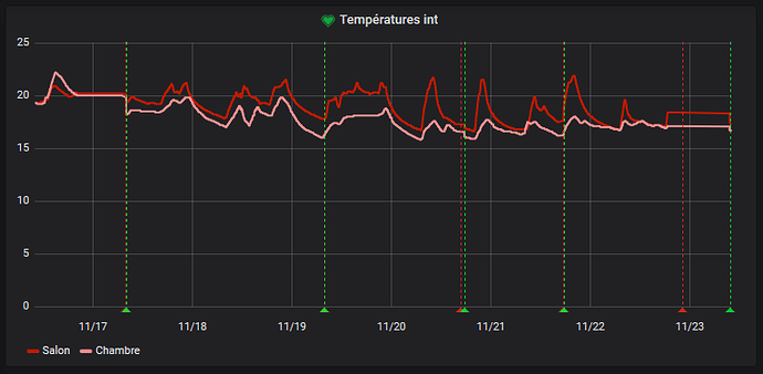

Thanks for pointing to this information Angelo, yet I think tonight’s problem on Netatmo infrastructure is a coincidence and doesn’t account for all the problems discussed in this thread. Here’s a Grafana screenshot showing disconnection of the NEtamo. Each time, I had to recreate the openhab container to have it work again.

Ok, you’re right, there is clearly a running problem on Netatmo’s side since a few days.
Then, it look like for some reason I cannot understand, our binding seems unable to reconnect to the API after is is repaired on netatmo’s side until we restart openhab.
