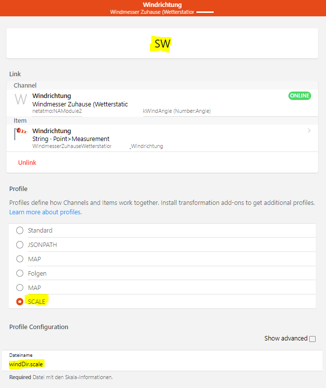

Everything worked fine. The item showd a number value in degrees and did so on my sitemap. But because this is difficult to read I wanted to scale the vaule to the typical terms (N, S, W, etc.). So I installed the Scale Transformation Service an followed this german guide OpenHAB Windrichtung von Grad in Himmelsrichtungen konvertieren.
So I created a windDir.scale file, changed the item type to string and changed the channel link profile to SCALE.

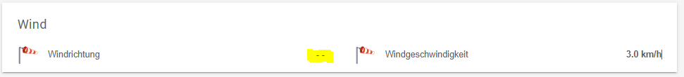

Still everything worked fine. My item now looks like this:
You can see the transformation works and the item value is now “SW and no longer a number”.
My only problem is now no value is shown on my sitemap:

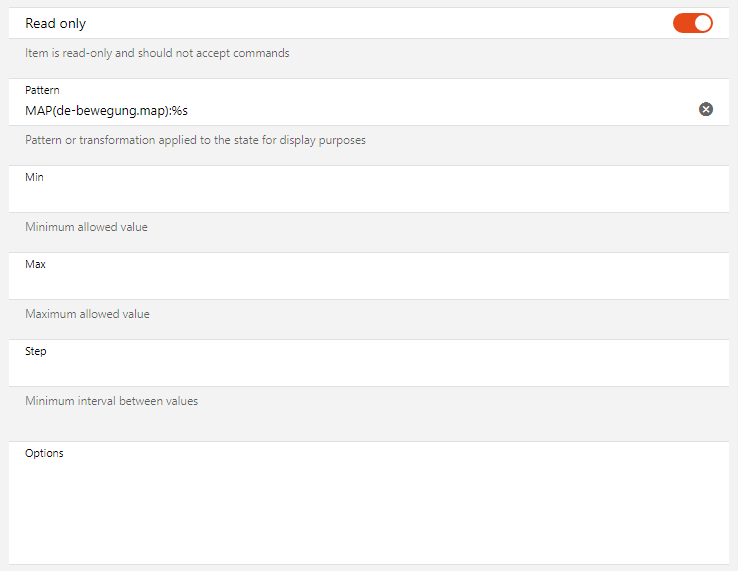

Most likely your Item still has a state presentation ‘pattern’ suitable for a number, not a string. Check its metadata.
That was a good hint:
Old metadata:
  "link": "http://<openhab>/rest/items/WindmesserZuhauseWetterstationXXXX_Windrichtung",
  "state": "SW",
  "stateDescription": {
    "minimum": 0,
    "maximum": 360,
    "step": 1,
    "pattern": "%d %unit%", ### OLD
    "readOnly": true,
    "options": []
These stateDescription are getting set when i link the channel. So even creating a new string item does not help because as soon as I link the channel the stateDescription for an angle are getting set.
I am mostly using the UI, where I can’t see this pre set Metadata so I looked via REST API to confirm the wrong Metadata. I was then able to change the stateDescription:pattern via UI by “Add Metadata” → State Description → Pattern → “%s”. That did not delete the other unnecessary stateDescription minimum, maximum and step but was enough to get my sitemap working.
