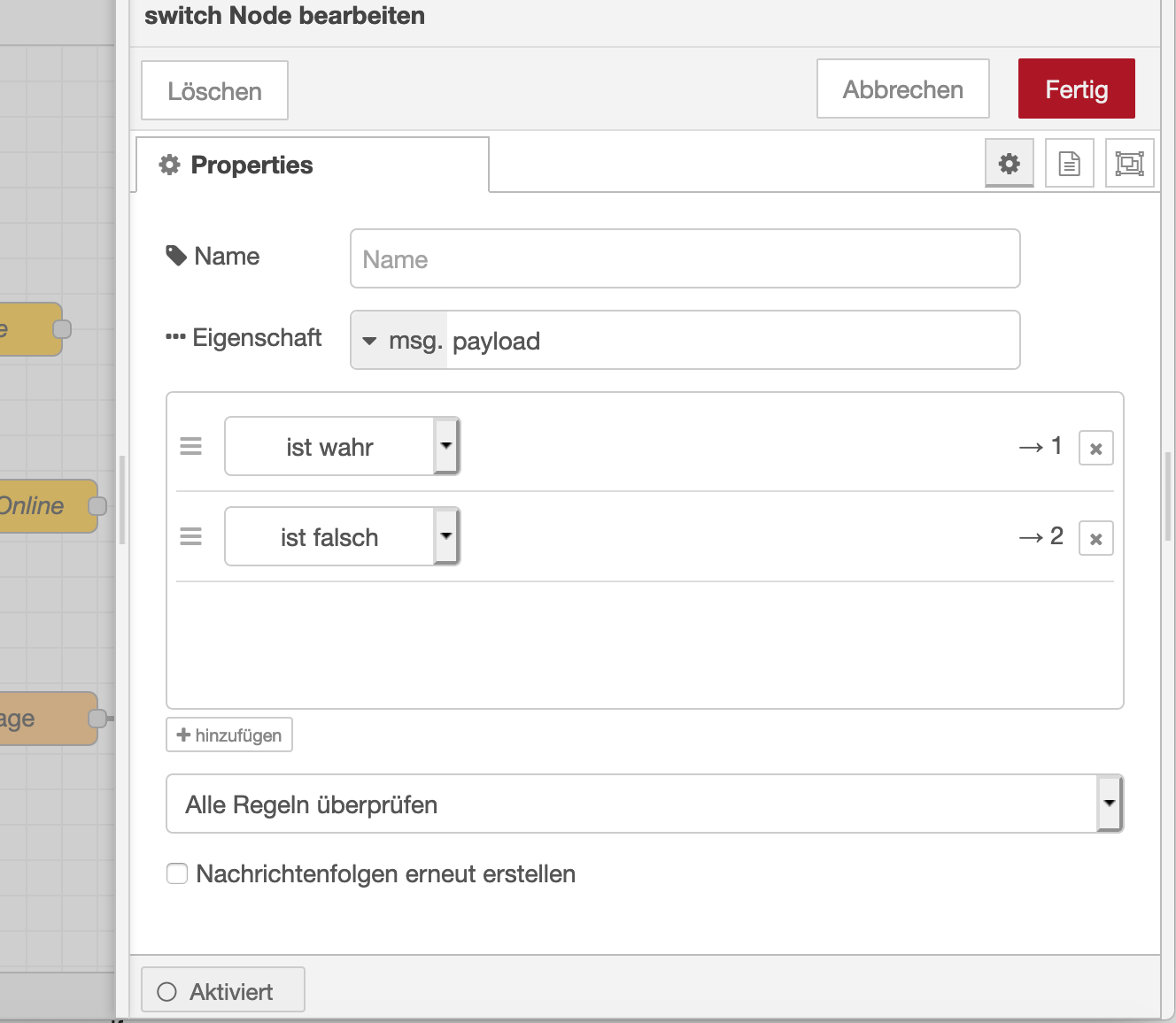

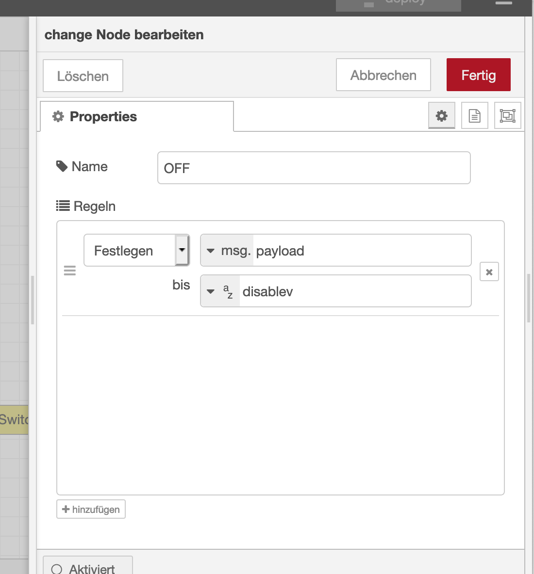

Basically the HomeKit ivpn switch (in the middle of the workflow) sends true on port 1, and false on port 2 (picture 2) based on the template defined (picture 1).

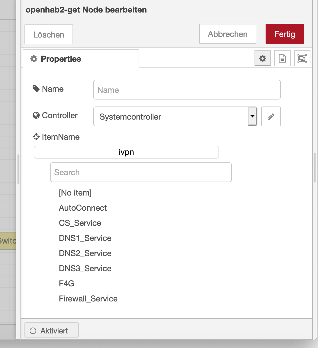

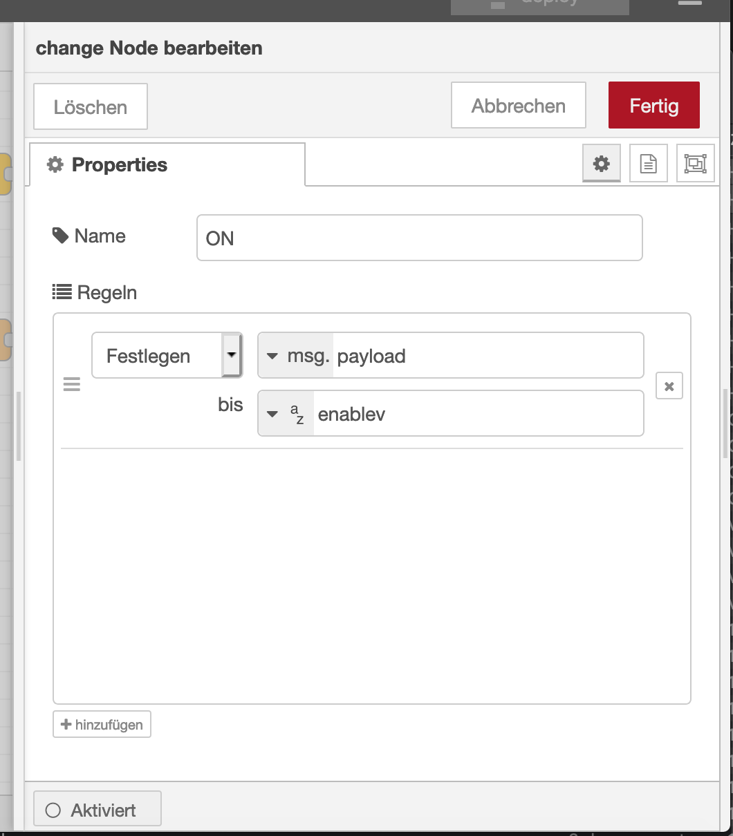

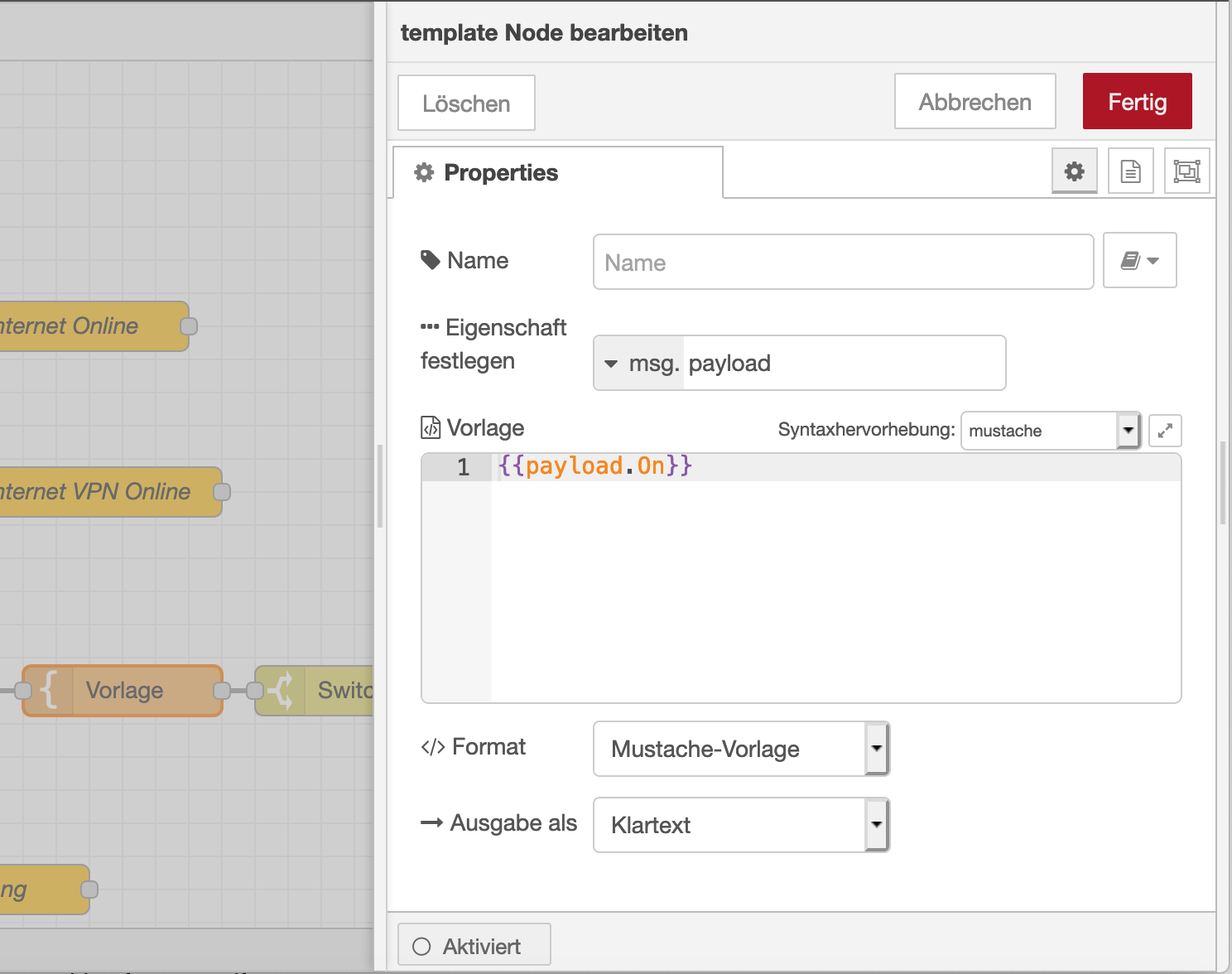

The questions: How do I send the value (the value/command is enablev for On/true, the value disablev is for Off) to the ivpn openhab node (picture 3 and 4)? And which openhab2 node (picture 5) for the item ivpn do I need to take i.e. openhab2 get or openhab2 out? With which settings?
Picture 1:
Picture 2:
Picture 3:
Picture 4:
Picture 5:
