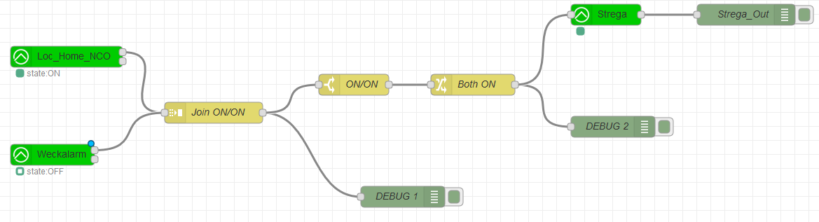

I just started to play around with Node Red and have a rookie question.
With my alarmclock in the morning I would like to switch ON my coffee machine.
But only if I am at home.
I have realized this with the following structure, but I assume there must be a much simpler way.
What I do is, I join both to ON/ON and just let this through. I then change ON/ON to ON to switch the coffee machine (Strega).
A short feedback about options to improve (simplify) are greatly appreciated.
You could use an openhab get node triggered by the change of your alarm clock item that gets you presence and than a switch node which evaluates only this. That way you would have two nodes less but any way that works reliably is good :smiley:

Hi Johannes,
that’s a good hint (I just started playing around with it).
My expectation would be that the switch returns “ON” only if I use this approach:
However, it returns the entire message like:
22.6.2019, 07:23:22node: DEBUG 1
msg.payload : Object
{ link: "http://localhost:8080/rest/ite…", state: "ON", editable: false, type: "Switch", name: "Loc_Home_NCO" … }
EDIT:
Got it myself: I needed to put a change node behind it to set the msg “msg.payload” to “msg.payload.state”
:smile:
