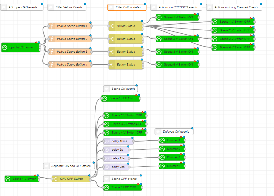

I’ll post my working statement for others to work from.
Cheers
Stuart
UPDATE
So the && (AND Condition) in the IF statements didn’t work for me, but with a switch node after the IF Function, I can see the three different states from the Velbus buttons.
The premis is that there are Virtual switches in openHAB2 that can be set in the UI or Voice Commands etc
Each Scene switches OFF the other scene switches and set out ITEM states.
There are Feedback LEDs that can have their state changed.
Here is the Flow code for anyone that is interested.
(I’ve removed the actual items and openHAB controller, so you’ll need to tweak each node to suit your installation)
Please feel free to advise / revise this flow, as this is my First venture into NodeRed

        "id": "45e52b76.6b0284",
        "type": "comment",
        "z": "3bd26249.fa856e",
        "name": "ALL openHAB events",
        "info": "This node provides ALL of the bus events within openHAB\"",
        "x": 100,
        "y": 40,
        "wires": []
        "id": "a5dbe336.659e7",
        "type": "comment",
        "name": "Filter Velbus  Events",
        "info": "These IF statements filter specific Velbus button events",
        "x": 310,
        "y": 40,
        "wires": []
        "id": "49f8431e.bdf8ec",
        "type": "comment",
        "name": "Filter Button states",
        "info": "Divides up the button status' into\n\nPressed\nLong_Pressed\nReleased",
        "x": 590,
        "y": 40,
        "wires": []
        "id": "8aa80ec6.488f5",
        "type": "comment",
        "name": "Actions on PRESSED events",
        "info": "",
        "x": 820,
        "y": 40,
        "wires": []
        "id": "f511e83f.d12d48",
        "type": "comment",
        "name": "Actions on Long Pressed Events",
        "info": "",
        "x": 1090,
        "y": 40,
        "wires": []
        "id": "3e53dcb3.809a14",
        "type": "comment",
        "name": "Scene ON events",
        "info": "",
        "x": 560,
        "y": 420,
        "wires": []
        "id": "ed0e1118.8dad",
        "type": "comment",
        "name": "Scene OFF events",
        "info": "",
        "x": 570,
        "y": 840,
        "wires": []
        "id": "3d8e650a.9621ea",
        "type": "comment",
        "name": "Delayed ON events",
        "info": "",
        "x": 810,
        "y": 620,
        "wires": []
        "id": "e37a475f.3e7ba8",
        "type": "comment",
        "name": "Seperate ON and OFF states",
        "info": "",
        "x": 320,
        "y": 780,
        "wires": []

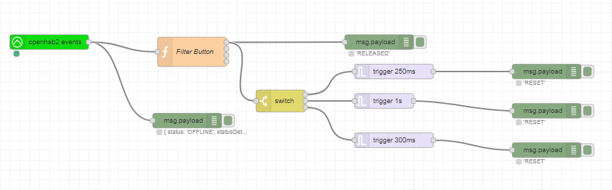

For anyone that is interested, here is my “working out” :smile:
        "id": "c1c183f4.eb661",
        "type": "openhab2-events",
        "z": "aa997a33.1a22b8",
        "name": "",

        "id": "83e9bf19.58393",
        "type": "function",
        "name": "Filter Button",
        "func": "var event = msg.payload.event;\nvar channel = msg.payload.channel;\nvar button = \"velbus:vmbgp2:c5053467:24:input#CH3\";\nvar newMsg = { payload: msg.payload.event };\n\nif (channel === button) {\n    return [newMsg];\n}\n\nif (channel === button && event === \"PRESSED\") {\n    return [newMsg];\n}\n\nif (channel === button && event === \"LONG_PRESSED\") {\n    return [newMsg];\n}\n\nif (channel === button && event === \"RELEASED\") {\n    return [newMsg];\n}\nreturn null;",

        "id": "36abae9e.736c92",
        "type": "switch",
        "name": "",
        "property": "payload",
        "propertyType": "msg",
        "rules": [
                "t": "eq",
                "v": "PRESSED",
                "vt": "str"
                "t": "eq",
                "v": "LONG_PRESSED",
                "vt": "str"
                "t": "eq",
                "v": "RELEASED",
                "vt": "str"
        "checkall": "true",
        "repair": false,
        "outputs": 3,
        "x": 590,
        "y": 1300,
        "wires": [
                "f4027050.bc3f9"
                "a85767f8.14f988"
                "4aec6972.c7a7e8"
