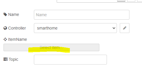

Hi guys,
I’m running OH 3.1,
and node red V2.0.6 on an other server,
I’ve installed the following palette:
node-red-contrib-openhab3
1.3.25
Are all these compatible?
I can’t seem to set my server settings correctly to start retrieving inputs,
do you guys use an auth key?
when I generate an api key, I get all my item statuses if I use the openhab events node’
but when i try to use an input it’s still blank

Hi All,
Found the reason for the problem…
has nothing todo with the Node or NodeRed !
i am using a Docker Nodered instance in combination with Hassio .. in that case all the NodeRed Entpoints get prefixed with /endpoint/ … so i had to change
line 545 in 77-openhab2.html from
$.getJSON("/openhab3/items", config)
to
$.getJSON("/endpoint/openhab3/items", config)
Hope this helps someone else doing the same thing and facing the same problem !
