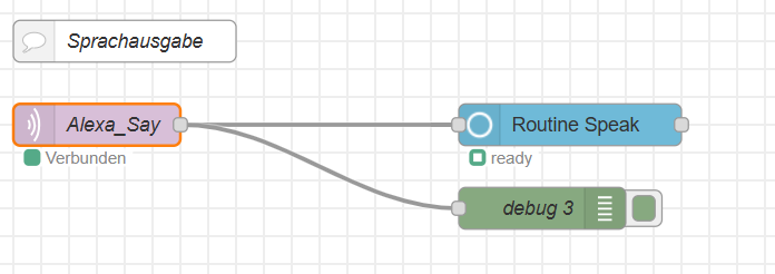

First I have create the Alexa account node and authenticate it and the mqtt broker node. Then I have create a small flow

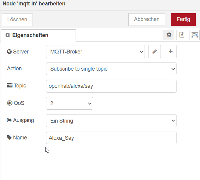

The MQTT Input includes the topic say - this will be set by openhab with the message to which is to send to alexa.

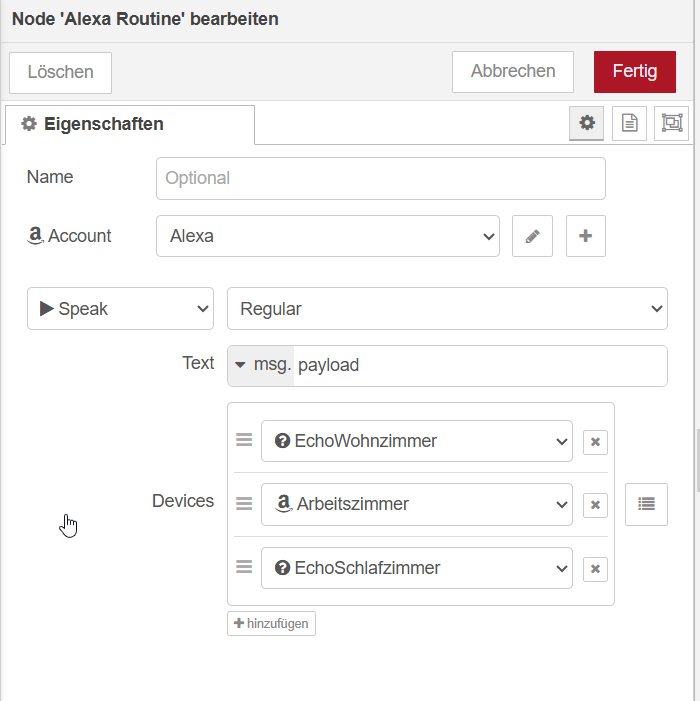

And thi is the node to send it to alexa
Thats all. I have add the flow of Larson and made some test. The good thing is that I can get the alexa command in a string. This i have never found in the binding. Every call to Alexa also generates an MQTT entry. This is well described by Larson.

you don’t even need the additional flow. You can directly click the mqtt and Alexa node in the imported flow and enter your accounts there. Node-RED stores them the same way
