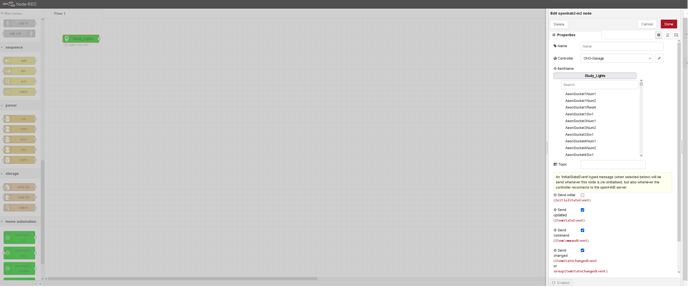

Thanks Justin, I did this. Still no state. I figure I can just create an openhab2-in2 node with my Item and thats all I need to display the state right? If so, no joy. The item names are populated (which makes me think the connect to the server is fine) but no state.
Your screens shot shows only one test item Study_Lights. Are you sure your Study_Lights item has a value? Is it a group with state NULL?

If I trigger the light via Alexa, I’d expect it to update, but it doesnt even read its current state, let alone a new state. I figure there is nothing I need to do to the node, other than select it from the drop down list of available items
That and select the OH instance that you’ve configured, but it looks from the screen shot like you’ve done that.

OK, worked it out! my error. Its displaying. For some reason Study was a legacy name, no idea why its there! Ive corrected it and I can see it working now
Its called ‘Study Lights’ in MainUI but the actual item is called BedRoom1Sw1, when I link it to the item name as BedRoom1Sw1, it works fine
