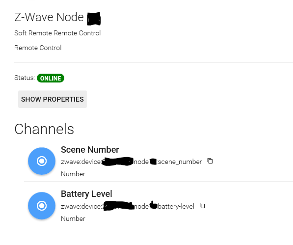

When I add the soft remote to my Z-Wave network he is not recognized bij openhab 2 (or z-wave binding)
in paper UI en habmin it shows up as Z-Wave Node 10 - Unknown Device

Yes, got it working (sort off)
It’s a battery device and you have to wake it up a few times before it is fully recognized by openhab
I have a rules like:
rule "Remote (1.0)"
  Item zwave_device_2x1b7x27_nodeXX_scene_number received update 1.0
   Lamp on command
Update 1.0 closed round dot icon
Update 2.0 plus icon
Update 3.0 open round dot icon
Update 4.0 minus
Thank you - I didn´t wait long enough - it works now!

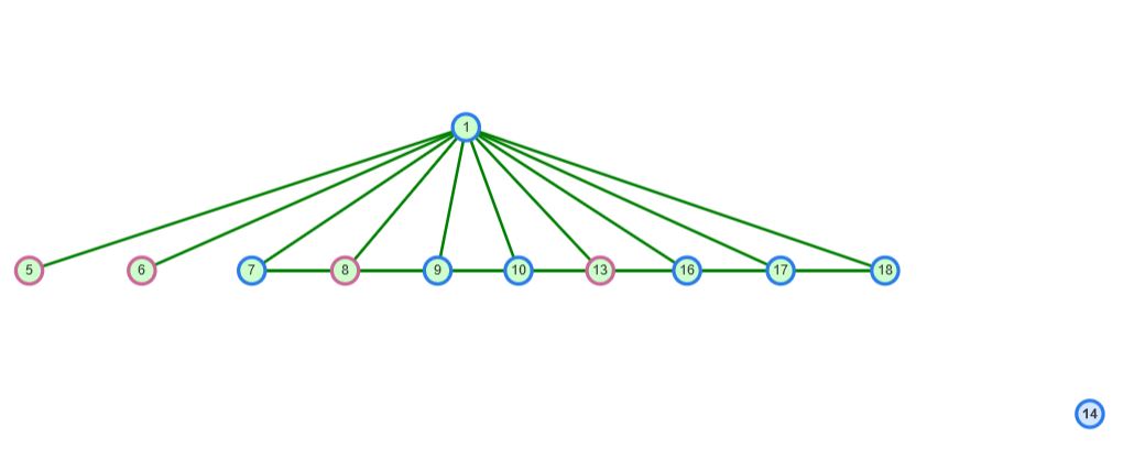

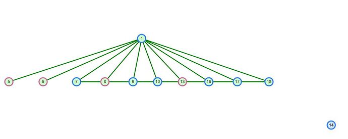

One strange thing i found is, that in the Z-Wave-Networkviewer of Habmin, my softremote is shown as completely standalone - connected with nothing else…
Do you have any Idea, how to get it to work like it should (Configuration etc.)
