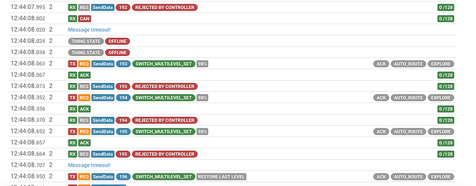

Ok I think Iam finally getting somewhere. Thank you for your patience working with me. The system is working now, but every now and then it looks like the controller gets stuck trying to communicate with one of my dimmer switches and I get a lot of failures on node 2.
I also have another dimmer switch Node 52 that was working fine, but now it does not recognize any commands sent to it from the controller. The system will recognize when I manually turn the switch on, and send its status back to the controller. I am not sure if any of this is related to my slow response/lockup issues I have every now and then.
