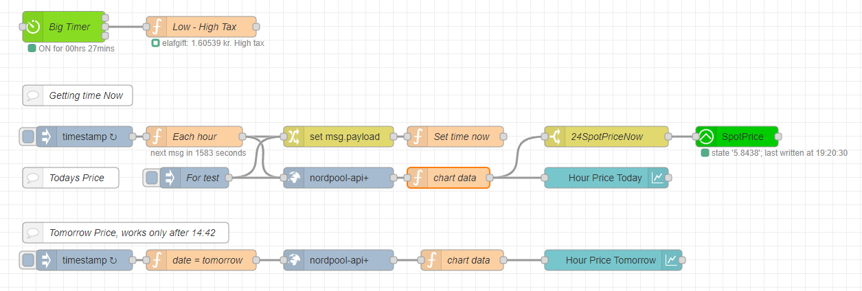

Hi Anders, I was struggling to get openHAB or Influx to show a graph with data in the future, so I ended up with just created a page with web link to elspotpris.dk.
Only number I needed in openHAB is the Spot price including tax and vat. Big Timer change between low and high tax depending on the hour, each hour request to Nordpool, this also set time now to global.set, chart data add the tax and vat, a change switch filter out the spot price now and update the item from openHAB
Nordpool to openHAB.json (14.6 KB)
thank you, it works well :slight_smile:
