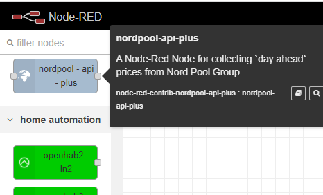

If you use Node-RED, then there is a Node for Nordpool api including example, from Node-RED you can update the item in OH

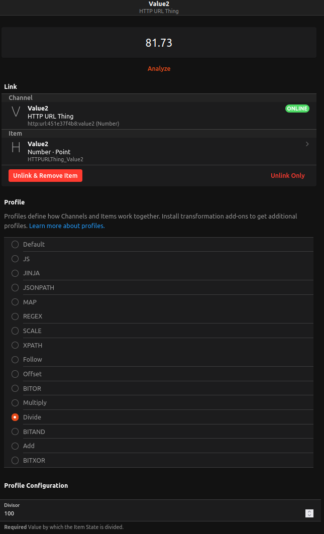

To get a usable Number type Item without messing about with files, you can use the Math Transformation Service provided by the SmartHomeJ repository, and then add a DIVIDE profile to the link between the Thing Channel and the Item.
