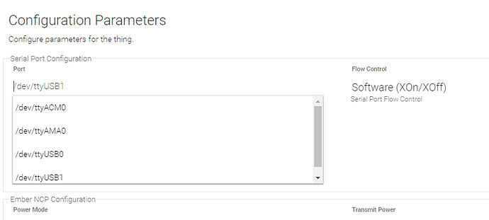

It appears the OS sees it as USB1 but the Java machine does not. The openhab thing configuration shows USB0 and USB1 as port choices, so at some level it’s recognized.

I don’t have any specific advice for trouble shooting. I have this dongle and it is working, or at least both the zwave and zigbee show as online.
Here are the settings I have in PaperUI for the coordinator in case it helps anyone.
  • Port: /dev/ttyUSB1 (USB0 is the Zwave controller)
  • Flow Control: Software (XOn/XOff)
  • Baud Rate: 57600
  • Power Mode: Boost
  • Transmit Power: Normal
  • Child Aging Timeout: 1 Day
