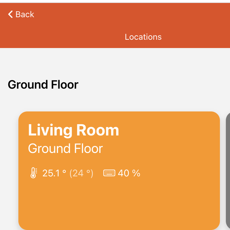

Not all custom badges are working, what am I doing wrong? Temperature and Humidity won't change
locations:
  - component: oh-locations-tab
      badges:
        climate:
          badge:
            icon: f7:flame
        garagedoors:
          badge:
            icon: f7:power
        projectors:
          badge:
            icon: f7:keyboard
        humidity:
          badge:
            icon: f7:keyboard
The climate, garagedoors and projectors badge icons all work but the humidity badge just won’t change. This is the same when I try temperature. Can anyone help?

Disclaimer: I never used above method for upgrading since I always use “manual” installation.
I took a full image of my sd card and had a play, I manged to get the 4.0 snapshot. I was missing openhabian-config and found instructions to install it here [SOLVED] Recommended package installation does not work - openhabian-config: command not found - #2 by Bruce_Osborne
I couldn’t get Java 17 working though, I manged to install it but java --version still shows java 11.
I did manage to change the main UI version for 3.4.2 and the pr seems to be working perfectly to me. I’ve been able to change the temperature and humidity badges both globally and per card.
Thanks for your work.
