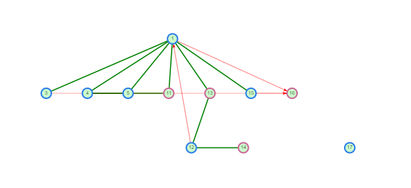

so no way to directly see and edit associations between devices
The Z-Wave Network Viewer under Tools is an attempt at that.
chris
(Chris Jackson)
May 16, 2020, 6:17pm
32
You can use PaperUI to set associations, or you can use HABmin - just not the version that your linked to as that was from 6 years ago and for OH1.
This doesn’t show associations - it shows neighbours.
