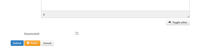

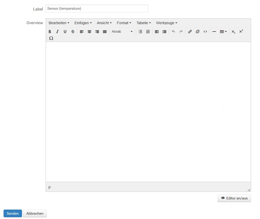

Maybe it’s not a big issue, but why does it say [deprecated]? I didn’t enter it and when I click EDIT it doesn’t show me this text.
grafik
Device: https://www.cd-jackson.com/index.php/zwave/zwave-device-database/zwave-device-list/devicesummary/206
@TimoT
Thanks for the tip. I had the same issue (it timed out), so did the uninstall first, and it all worked fine!
@chris @sihui
I’m pleased to say that unsolicted temperature reports are now working OK on Qubino ZMNHDD & ZMNHND following latest Z-wave binding update. Thanks for your help with all this.
Firefox issue. Use Chrome.
Tried IE, Edge, Firefox and even installed chrome - no checkbox :-/
Maybe it’s a user right? Could you remove the deprecated checkbox for me, please?
https://www.cd-jackson.com/index.php/zwave/zwave-device-database/zwave-device-list/devicesummary/206 (Endpoint 2, Temperature Sensor)
Thank you.
Maybe.
Done.
Thank you
