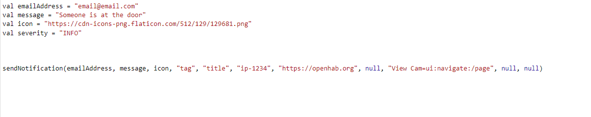

Sorry , unfortunately I couldn’t figure out from the link , about opening a custom tab from habpanel/page from the notification. I am also having a similar requirement. I would like to send a notification which can open an url.
Thank you, I managed to configure it, but I only managed to send a notification to my phone. I couldn’t find a way to redirect that notification to a custom clickable widget
I only managed to send a notification so far

Actually this functionality will make it in to 4.2 which is due out in the next few days, stay tuned!
Yes, I updated my OpenHAB to 4.2, but couldn’t manage to apply the action, no action button or action is executed when I click on notification:
Not sure if you read the release blog post, but if you had, there we mention that the clients are not ready for this new feature yet.
Both for iOS and Android App is already worked on implementing the required changes, but as of today, there is only backend support, not frontend support.
However was it super important to get the backend support into 4.2.0, so we can ship the updated apps later and before having 4.3.0.
