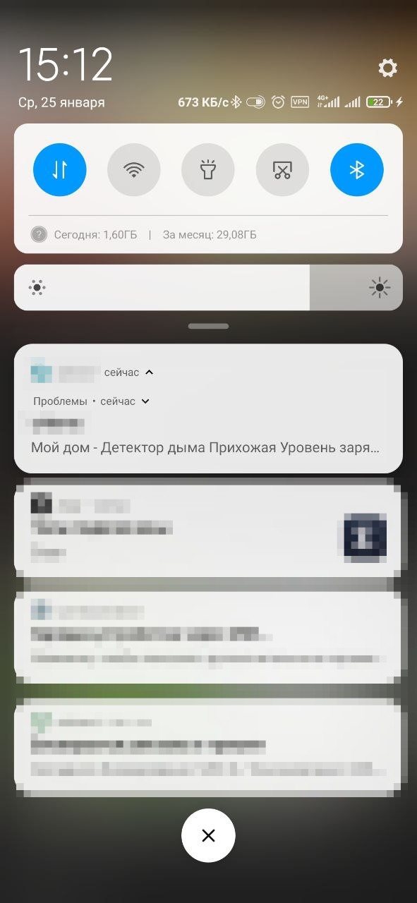

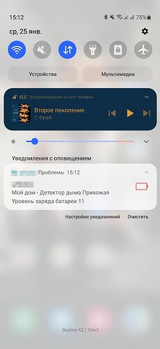

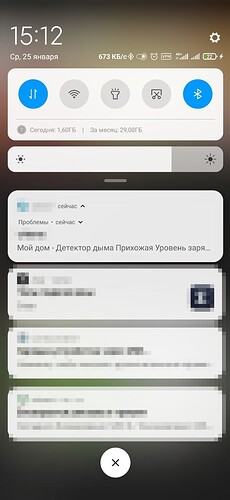

Hello! in notification i send icon. but not all notifications display the icon. i have own cloud server.

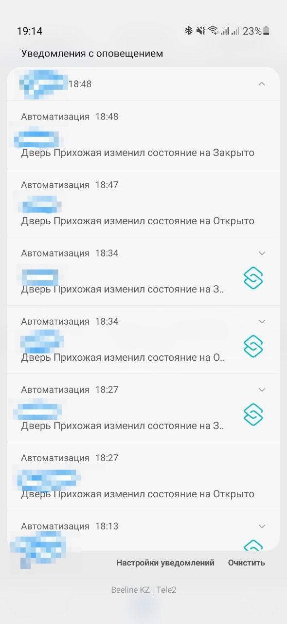

I have 3 devices. on 2 devices icon is visible, but on 1 is not

icon is unvisible
