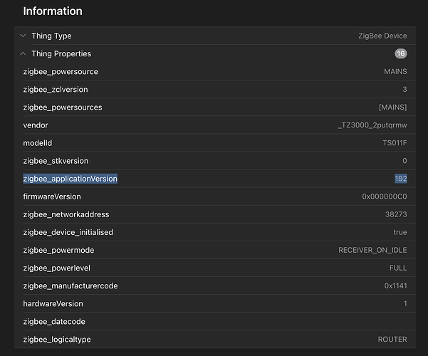

What I could imagine is a faulty firmware 78. At least I am now running on 192, if the unit fails, that will invalidate the theory. The more time passes without failure, would validate the issue.
This should be a none issue for Z2M users who can easily update the firmware with OTA. This is however a critical piece of information for OH/ZigBee binding users who may run into the issue. 4/6 items became unsable so far.

For reference, OH/Zigbee binding users can check the information in OH and see their firmware version. Here is what my update device looks like now:
