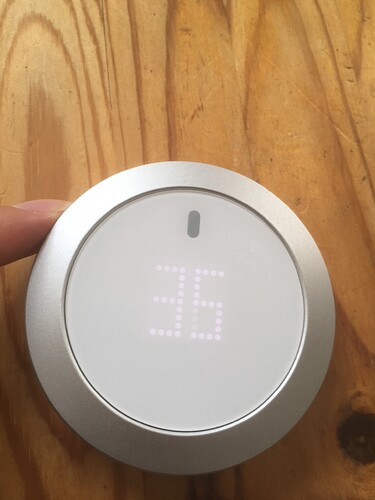

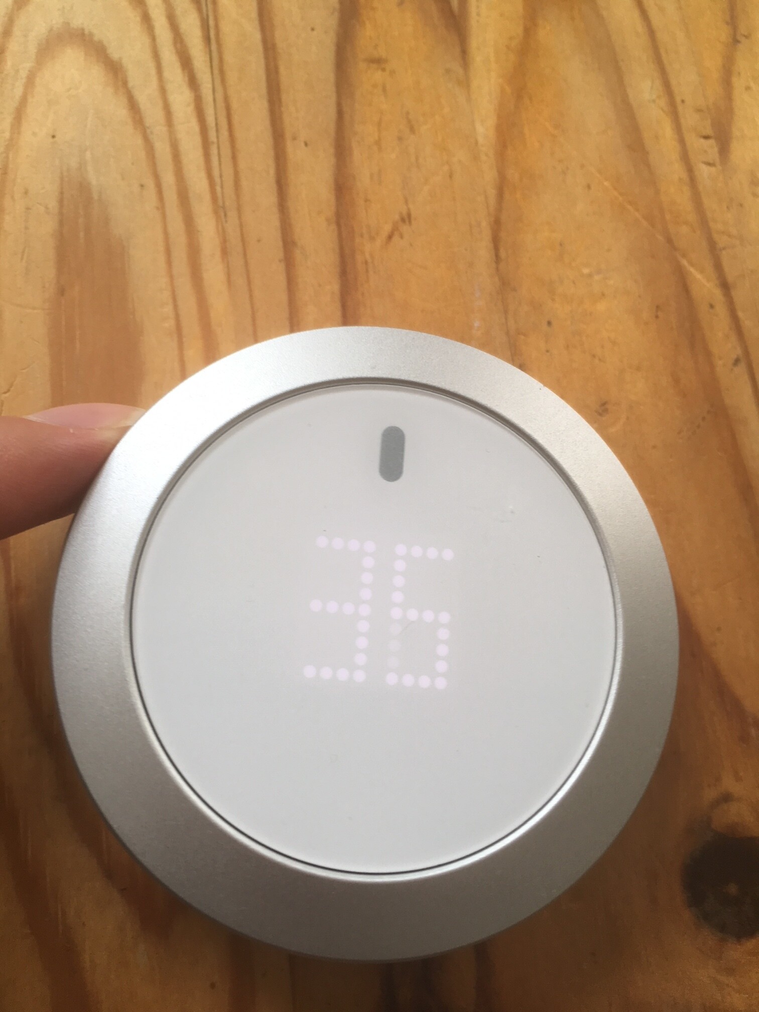

version 1.0 Stable is released now. Beside a bunch of bugfixes, there are also some new major features in this version:
  • possibility to show the battery level via LED matrix
  • possibility to track the battery level within openHAB (e.g. for notifications when the battery level gets too low)
  • possibility to show the battery level or the slider state with a 2-digit number (100 is also supported as a special case) → see picture below
