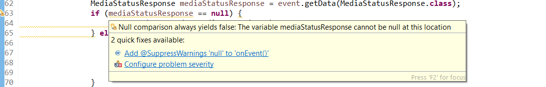

Null comparison always yields false is false
I’m trying to work on the Chromecast binding a bit, and while this isn’t neither new nor a showstopper, it just annoys me to have a lot of warnings everywhere, because they drown out the “real” warnings that I might need to see.

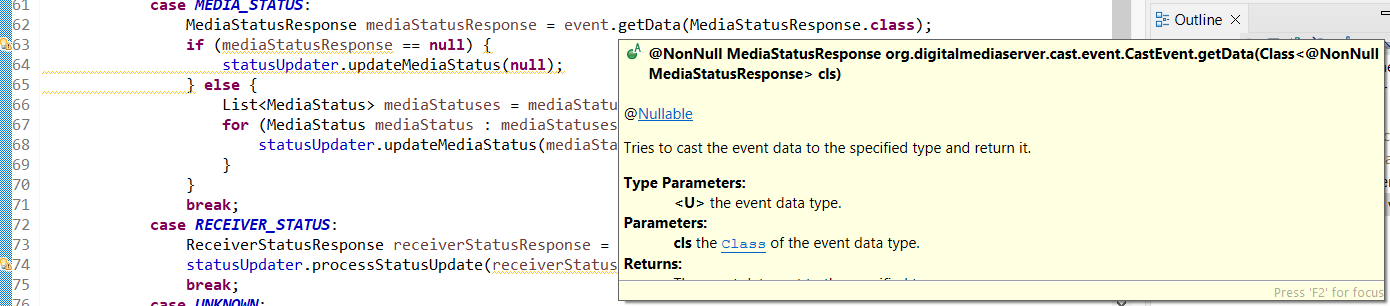

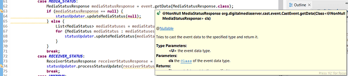

However, this is what Eclipse says:
The view of the JavaDoc for the method reveals the extent of the confusion:
It claims that the method is both @NonNull and @Nullable at the same time.
I’ve tried all kind of creative ways to apply @NonNullByDefault({}) to no avail. It is simply adamant that the method is @NonNull when it in fact is @Nullable. I’ve even tried removing @NonNullByDefault from the class, which usually resolves all “null weirdness”, but in this case, it makes no difference.
I just can’t fathom from where it gets the idea that the method is @NonNull - and I can’t find a way to tell it that it’s wrong.

Even worse, I also get a “unused code” warning here because of the erroneous conclusion it draws about nullness.
