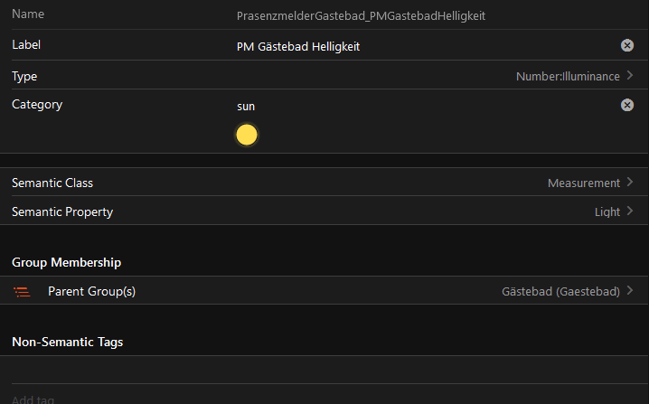

If I have a look at the item, it looks like this:
Should “Type” = Number:Illuminance set the item’s unit to lx instead of °C?

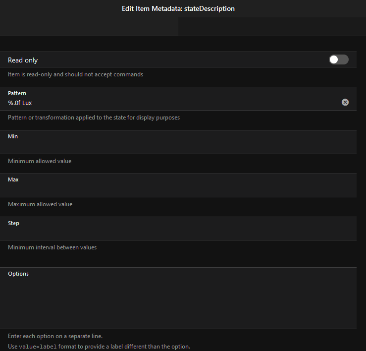

The item does have a state description:
If I remove the state description the warning is gone but the item does only show the number and not “Lux” anymore.
Where does the °C come from?
How can I get the “Lux” after the number if not by using the state description?

Yes, that tells OH that the units that Item accepts are those that represent illuminance which, in that specific case is only Lux. Note, the actual unit is lx not Lux.
The state description only changes how the Item is shown. The actual Item’s unit is controlled by the unit metadata (see the breaking changes for OH 4) or, if not defined at all, the system default which depends on your locale. Given illuminance only has one unit, lx should be the unit assumed.
What is updating this Item? Does it include °C as the unit? If an Item with a unit gets updated with a state with a unit, OH will try to convert from the sent unit to the unit carried by the Item.
