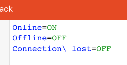

Many transformations require a separate configuration.
For example, MAP requires a table with key=value pairs that maps a given state to the desired value.

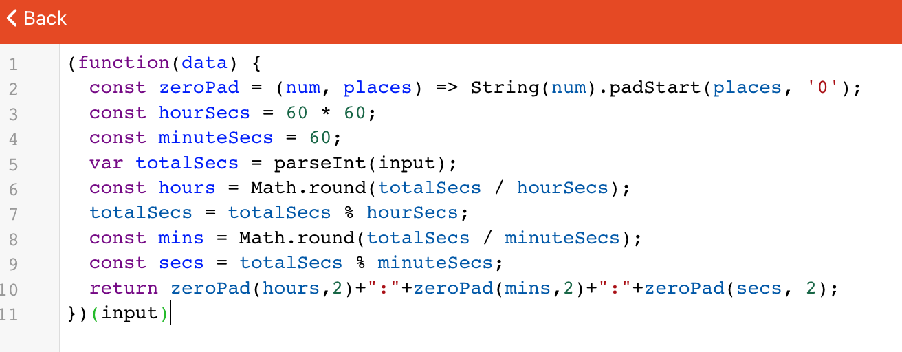

If you have a complicated script based transformation, you can define it there as well.
Note, this last transformation really isn’t necessary. It’s better to use a Number:Time Item and use the State Description Pattern to transform it to HH:MM:SS.

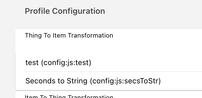

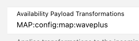

To use these go to the Link between an Item and a Channel, the Item’s State Description, or anywhere else a transformation is supported and if you cannot simply select it like so:
or enter the ID of the transform if selecting one isn’t possible (selecting the transform has not be implemented everywhere in MainUI yet):
If it’s a simple script transformation that fits on one line of code, you can enter the transformation directly on the line as shown in @jimtng’s example.
