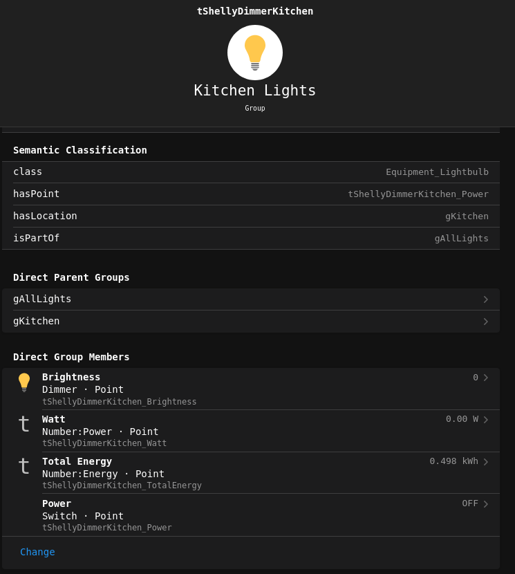

Sure. Since I configured everything via the UI, I’ll share a screenshot (isn’t there some textual configuration stored somewhere, also for items defined via UI?).

Either way, to me this setup seems strange - I’m not sure that a Group with aggregation functions applied should hold a number of different types of members. You’ve got numbers, switches and dimmers in the same Group. Usually, a Group with aggregation functions applied has members of a single type (only switches, or only numbers holding energy values etc).
