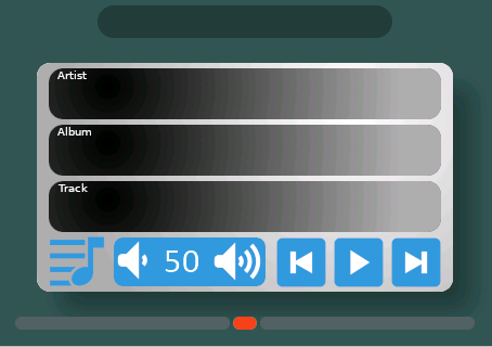

I put a temp vol slider on after you said about volume, just so it sent events. but i hated it so did it properly! lol
You have a version in the middle, just get the lastest and it should be fine. it will send
{"media":{"volume":60}}
on mqtt, when you use it.
pause/play is now a toggle button, sending;
11:34:32.275 MQT: tele/nspanel/RESULT = {"media":{"action":"play","volume":70}}
11:34:32.942 MQT: tele/nspanel/RESULT = {"media":{"action":"pause","volume":70}}
Incoming, you’d send;
{ refresh: {pid:n, name:x, media: { album: a, track:t, artist:a, volume:v }}}
(obviosuly, in valid json with all the quotes, not my shorthand)

@m-home are you sure you have uploaded? I just downloaded from github and I still have the volume at the top.
I thought I had, it was late, so maybe I forget. I’ll release again shortly with a few other tweeks
v1.0.0-beta11
  • Media Pages Impoved
  • Home Page warnings fixed
  • New start message to assign first swipe page
{"start": {"pid":n, "format":n}}
