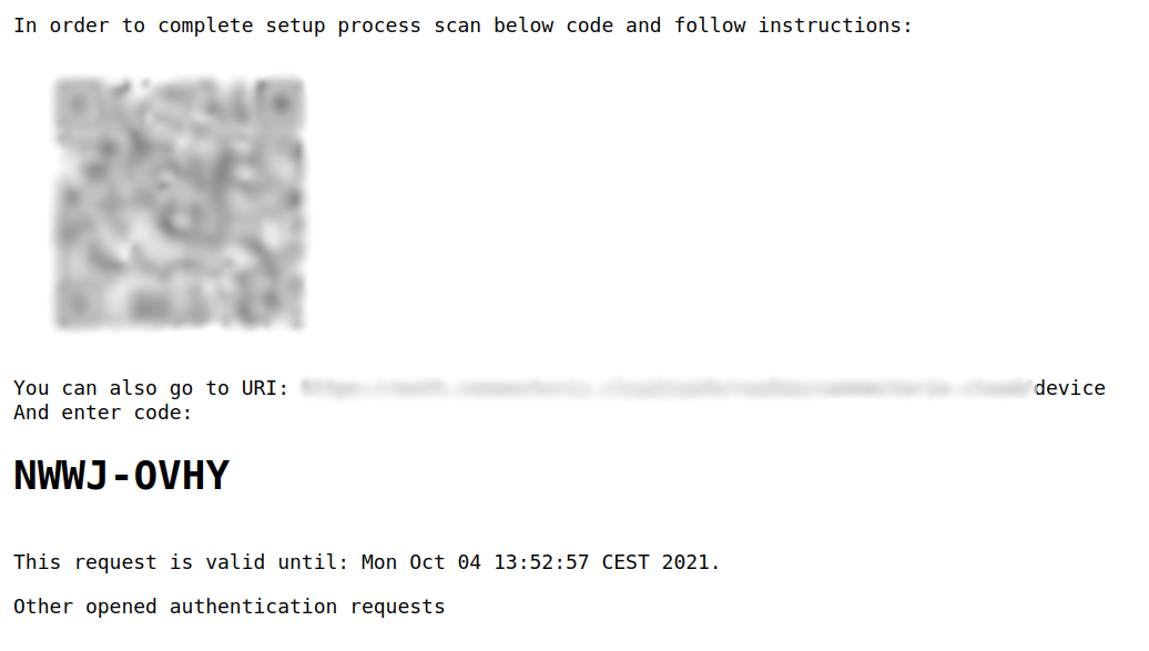

Hey Marc,
I have implemented Device Flow client (see here) and also created compatible OAuth 2 Device Flow server. Sources are available over here:
If you look there - there is device side of authentication, meaning polling for the code, basic user interface (servlet) to display it for end user, as well as completion of process. Once authentication is completed a DeviceAuthentication service is being published.
Few points to be taken - A) in my design it works fine with service cause it is being used for both websocket and mqtt connections to central server. It might not be good design for multi-binding approach.
B) You can request (usually) multiple device codes and your binding/thing handler needs to either forget old requests or memorize them for time of their validity (I do neither).
C) You might need an extra parameters added to request so server can identify your device in a reliable way. For my own service I used sha(instance-id), however I plan to switch to more reliable identifier such as client certificate.
Here is how UI looks a like:
If you try to get device flow working on OH side then for consuming side (device) it is, as you found, rather simple. I’ve done this using third party library called nimbus-ds instead of writing N-th time the handling code.
