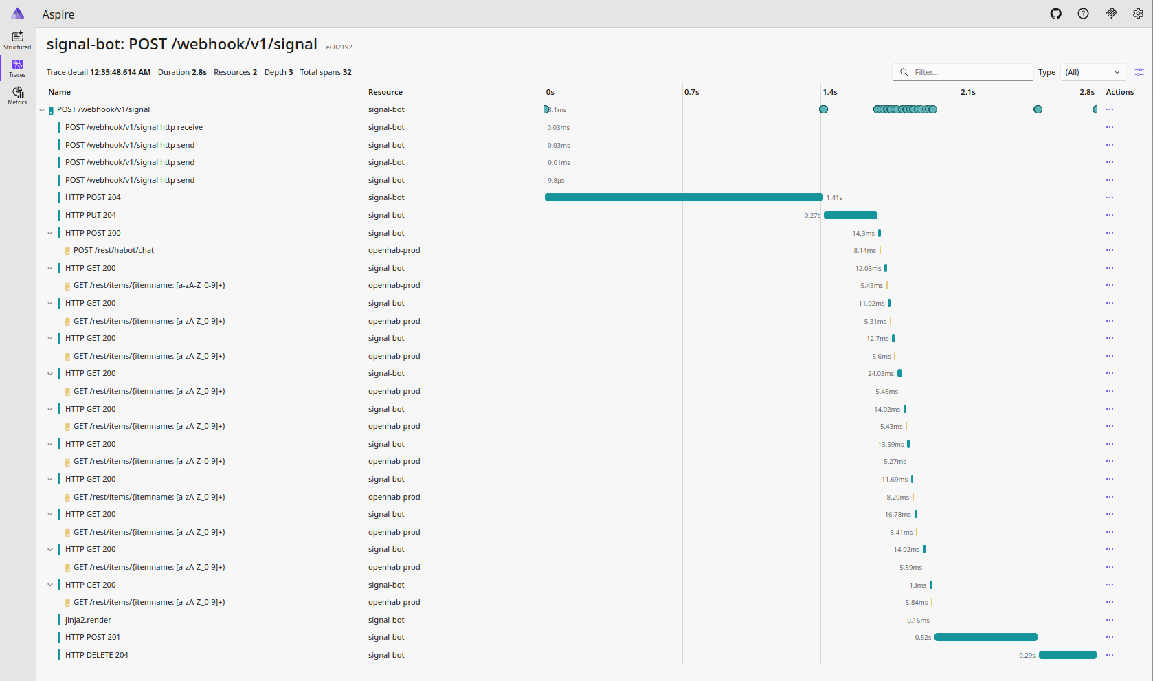

This is an old thread, and I am sure the technology has improved since this was written, which has enabled me to get some simple Otel integration working with OpenHab by starting the Otel Java Agent. It seems to be working well. I have Otel configured in a small app I am playing with, which calls into OpenHab to chat with the Habot API and to get Item statuses from the OpenHab REST API.
My process was:
  • Download the Otel Java Agent jar onto my OpenHab VM
    curl -L -O https://github.com/open-telemetry/opentelemetry-java-instrumentation/releases/latest/download/opentelemetry-javaagent.jar
  • Start the Aspire Otel Dashboard. This is the service that listens for Otel events and has a dashboard to view correlated events. I run this on my docker VM.
    There may be others, but this is one I was already familiar with.
  • Configure OpenHab to start the agent.
    sudo vi /etc/default/openhab
  • Find the line for EXTRA_JAVA_OPTS and add the options to start the otel java agent
    I’ve split the lines up for readability, but in my file they are all on one line inside quotes.
    -javaagent:/home/openhab/opentelemetry-javaagent.jar
    -Dotel.service.name=openhab-prod
    -Dotel.exporter.otlp.endpoint=http://docker:4317
    -Dotel.exporter.otlp.protocol=grpc
    The Aspire engine exposes a port for GRPC, so I had to set that port (4317) and protocol (grpc).
  • Then restart openhab
    sudo systemctl restart openhab.service
I can now see Traces, Logs and Metrics in Aspire’s dashboard showing my Signal-Bot talking to OpenHab. Both are configured to push events to my Aspire container. There are other services in use too, but I have not yet managed to convince them to push events to Aspire.
