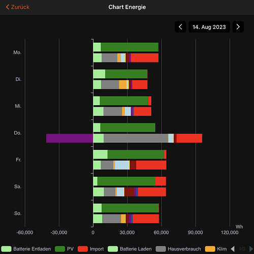

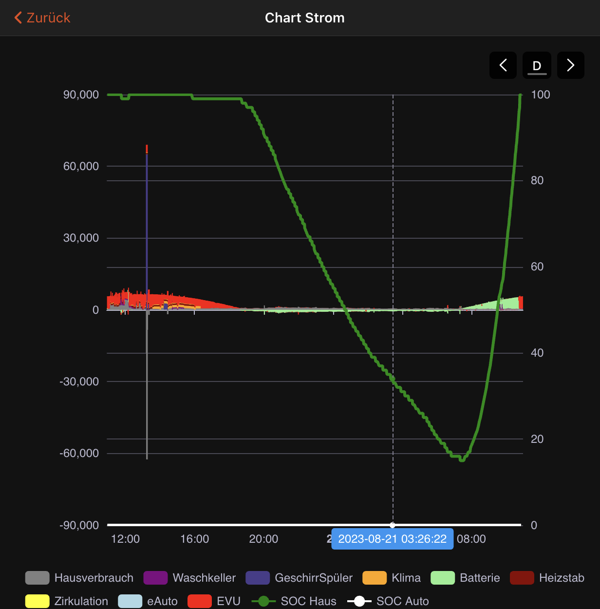

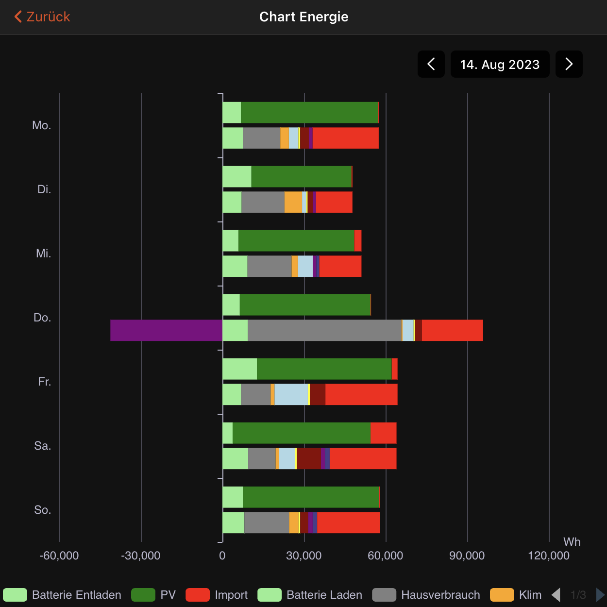

I have occasionally the issue, that exactly at 00:00, when I do a lot of rules (daily calculations and resets a.s.o.) I hav a wrong value anywhere, because sometime a rule is not exacltly fired and or some reconditions are not done. This results sometimes in wrong values for the day.
The same sometimes happens when playing around and doing a mistake somewhere
Not really dramatic, but annoying.
So it would be cool, to have the possibility to manually change the values to a (more) correct value, to have this spikes away in history.
