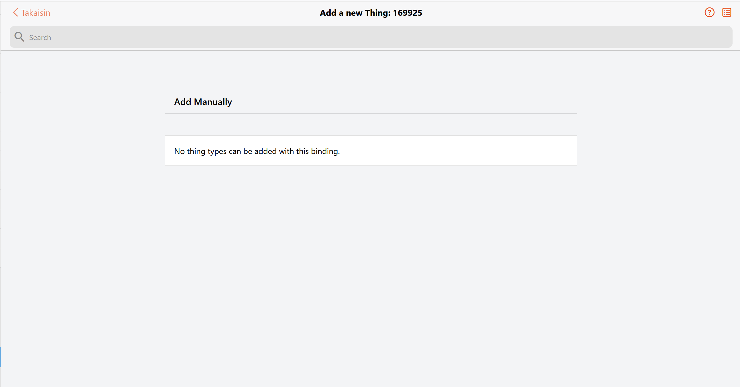

I have tried to connect my car to the charger but still Connector is not in the INBOX. I have also rebooted the Alfen.
Here is a copy of the log:

I have also restarted OH and uninstalled/reinstalled OCPP binding. I have now noticed that I can’t add manually new Things in OCPP binding:
that log nailed it — this isn’t a config problem on your end, it’s a bug in the binding. the OCPP library i embed is rejecting your charger’s BootNotification because alfen sends a model or vendor string longer than the 20-char limit the spec sets, so the charger never actually boots and nothing downstream (incl. the connector) can come up. a central system shouldn’t refuse a boot over that, so i’ll make it tolerant.
if you can grab one more thing it’ll help me confirm and verify the fix: log:set DEBUG eu.chargetime.ocpp, reconnect the charger, and paste the received BootNotification frame (it’ll show the exact chargePointModel / chargePointVendor). thanks for the detailed logs, this is genuinely useful.
I haven’t tried yet to do the debug logging. I uninstalled the binding and manually added all 3 Things. They all are now “ONLINE”. Do I still need to do log:set DEBUG eu.chargetime.ocpp?
Well if all three are ONLINE. and that tells me i jumped ahead earlier
there’s still one separate thing from your log worth a look only if you feel like it: the binding was rejecting your charger’s BootNotification. it’s not blocking you — the charger comes up from its other messages — but a rejected boot means the binding skips the metering setup it normally sends right after boot, so you might not see the full MeterValues set. if you ever want that sorted, log:set DEBUG eu.chargetime.ocpp, reconnect, and paste it
and a quick sanity check while you’re in there: try a current-limit change or start/stop on the connector to confirm control actually takes, not just that it shows ONLINE.

2026-08-09 16:51:04.611 [DEBUG] [ternal.transport.ChargeTimeTransport] - OCPP JSON server listening on 0.0.0.0:8887
no problem, glad it’s making sense now. and yes you’ve got it exactly — pause ON stopping the charge is normal, that’s just what pause does. the real bug was the other direction: turning pause back OFF didn’t resume if you had never set a current limit, it left the charger stuck in SuspendedEVSE. that part is fixed now, a resume clears the limit instead of sending another zero.
for the jar, it’s on the release page under “Assets” — github collapses that section by default so it’s easy to scroll past: Release OCPP Binding 0.1.0 (preview) · stamateviorel/openhab-addons · GitHub — but that one is the older build without the pause fix, so i will put a fixed build at the same link shortly, maybe wait for that. if you do try the current one, just don’t touch the pause switch, or set a current limit before you un-pause.
when you redo the setup, the thing that trips people up is the charge point id — it has to be the path of the websocket url, like ws://:8887/, not a separate field. whatever id the charger dials with has to be the chargePointId of your chargepoint thing, so easiest is to let it connect and accept it from the inbox, then the id matches for sure.
your log ends at “OCPP JSON server listening on 0.0.0.0:8887” with nothing after it — no charger connection at all. so nothing from the v2c is reaching openHAB yet, and that’s before the id or the thing even come into play.
two things, in order:
the url uses a hostname, openhab-prd.lan. chargers often can’t resolve .lan names, and if the connect fails on the charger side openHAB never sees it — which is exactly what your log shows. put the openHAB server’s IP there instead: ws://:8887/v2c-aveiro. also check the charger and openHAB are on the same network with nothing blocking port 8887. after you change the url in the v2c app, make sure ocpp is enabled and let it reconnect (a reboot, or ocpp off then on). then set log:set DEBUG org.openhab.binding.ocpp and watch openhab.log — you want a line “Charger connected: id=v2c-aveiro”. if it stays silent, it’s a network/dns problem on the charger side, not openHAB.
once it connects, the ids have to match. the charger dials /v2c-aveiro so its id is v2c-aveiro, but your chargepoint thing has chargePointId v2c-trydan. change the thing’s chargePointId to v2c-aveiro — or just delete the thing and accept the one that shows up in the inbox, it’ll come in as v2c-aveiro.
so: ip instead of the hostname first, get “Charger connected” into the log, then make the thing id match.
