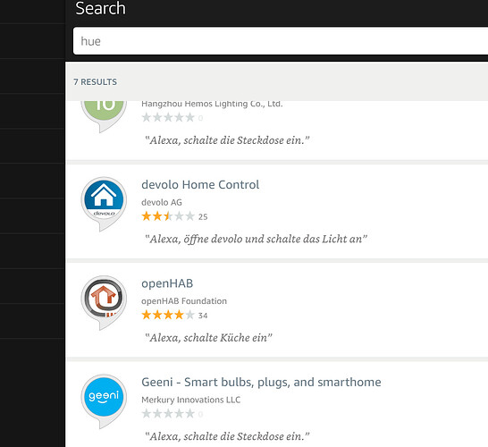

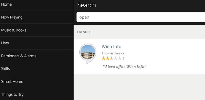

I tried to install openhab skill, but it is not visible any more. I am sure a have seen it some days ago.
Any idea what is wrong here?
strange, it is visible when searching for “hue”
