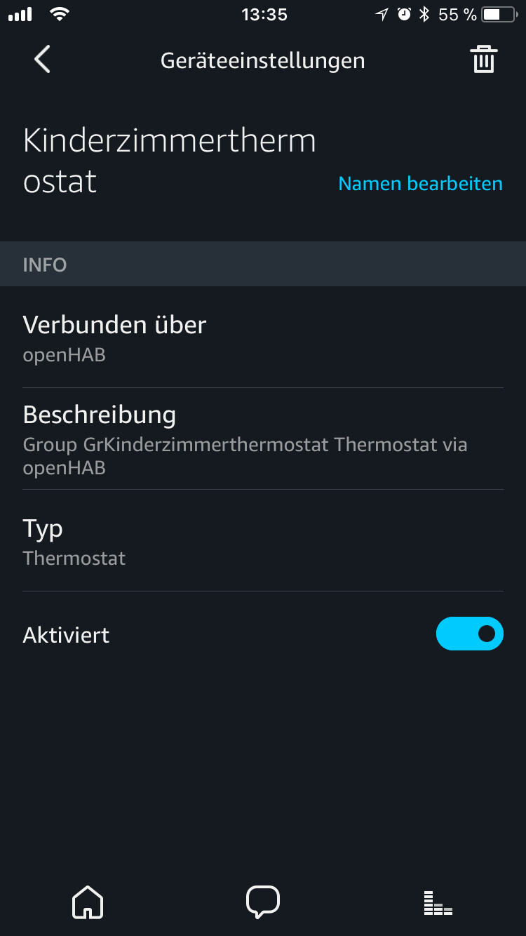

Hi!
I was forced to do a clean install of my openhab instance because i had huge issues i was not able to fix. I configured alexa again and it found all of my devices. Unfortunately my Thermostats are shown but there is now way i can edit the temperature (it was working back in 2.1).
My cfg:
Group  GrCouchthermostat 					"Couchthermostat" 								["Thermostat"]
Number WoZi_Thermostat_Couch_akt_Temp		"Couchthermostat aktuelle Temperatur" 						(GrCouchthermostat) 						["CurrentTemperature"]
Number WoZi_Thermostat_Couch 				"Thermostat Couch [%.1f °C]"					<heating>	(GrCouchthermostat, GrThermostat)			["TargetTemperature"] 			{channel="zway:zwayDevice:XXXXXX:thermostatSetPoint-ZWayVDev_zway_XXXX"}
String WoZi_Thermostat_Couch_Modus			"Couchthermostat Betriebsmodus"								(GrCouchthermostat) 						["homekit:HeatingCoolingMode"]
I have 3 Thermostats. the screenshot and the cfg don’t match but you get the idea. it’s identical on all 3
