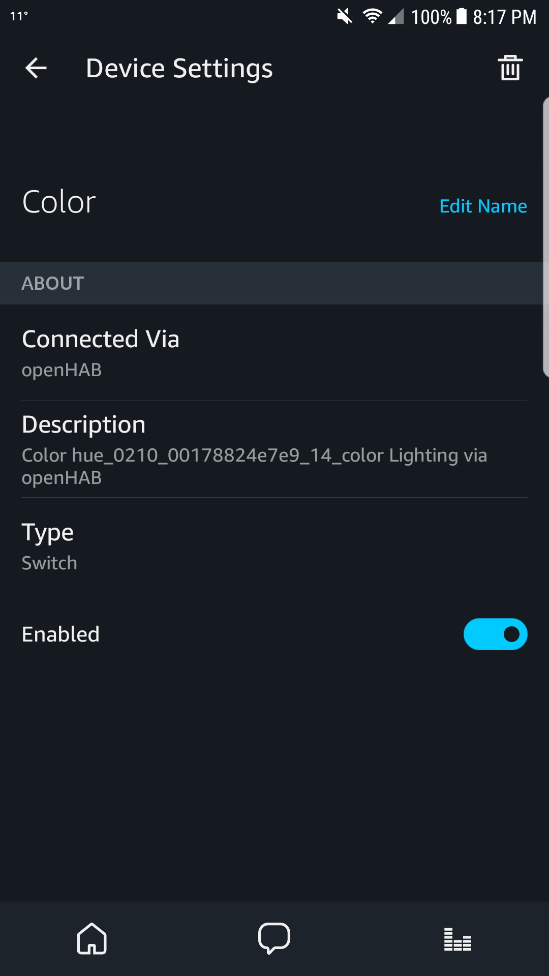

Currently, I have added only 2 Light Switches to my OpenHab Items with a [ “Lighting” ] tag and those show up when I scan for new devices.
But what is strange is that when I scan for devices, I am also seeing 3 “Brightness” devices and 10 “Color” items as well which corresponds to the 3 Lux and 10 Color Hue bulbs I have as well. My items file do not have these items included so I’m uncertain of why these keep showing up.
The ‘Color’ Items also so show an On and Off button and Power levels, and not actual color setting as well.
As an example, here are a few of the “Color” items Alexa is scanning as an Openhab2 device. The do not include a [“Lighting”] or other Alexa type tag.

Is there a way to keep these from showing up?
Have you checked your paper ui? Maybe the items are linked there.

I checked that, but have nothing linked to my hue items, so unsure why the OH2 skill is adding the with a brightness and color. Here’s an example of one.
