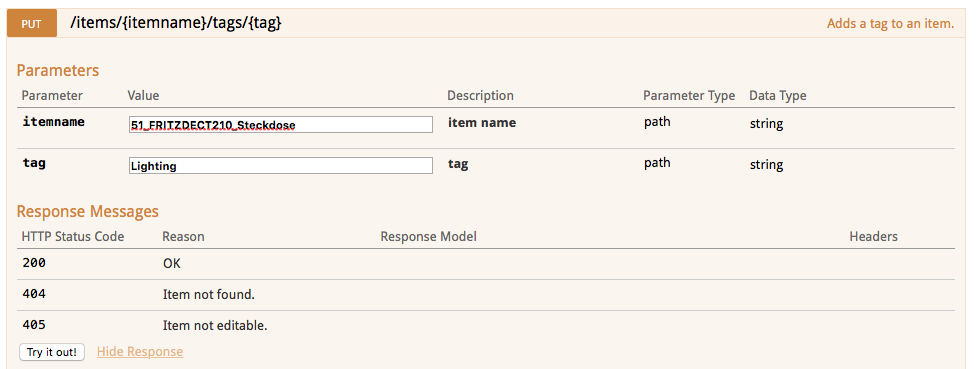

I use the Rest-API for Tagging items, there is no need to create text files.

@Toddah @RayMYP There are two ways of tagging: I desrcibed it earlier here:

Could you give some mor details what was necessary to change? I assume you have to change the openhab cloud url and deploy the skill to aws (or similar) ?
