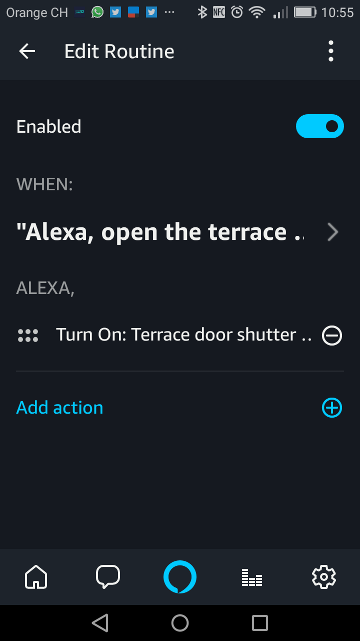

You can make Echo respond to any speech you want using “Routines” in the Alexa App (not the browser version).
Create a new routine.
Decide what speech you want
Link the speech to an Alexa-enabled openHAB routine (virtual switches and rules are useful here).
I used to have to say “Alexa, turn on the terrace door shutter UP”.
Now I say, “Alexa, open the terrace shutter”.

Sure.
I ought to point out that using routines, Alexa doesn’t analyse the text string for values etc so it’s one string for one command. What that means is that if you want the shutters at 50%, you’ll need a routine with a string which explicitly states “Alexa, set shutter to 50%” and if you want your shutters at 30%, you’ll need a new routine created which states “Alexa, set shutter to 30%” .
My example is with a security roller shutter which I only want totally up or totally down.
My example is a bit complicated too as the shutter is Bubendorff and you cannot access the RF codes themselves so I use an Arduino to set the old remote switch levels to 0V or 3V3 and MQTT for the Arduino to talk to openHAB via wifi.
It was one of the first things I did with openHAB and I’m going to improve it - one day.

Next you need to discover the Devices in the Alexa app.
After that, in the smartphone/tab app:
  • Menu
  • Routines
  • “+” When this happens…
    Add text for what you want to say:
  • “+” Add action…
  • Select “smart home”
  • Select "Terrace door shutter up!
  • Save
Create a second routine for Shutter Down.
Wait a couple of minutes for Alexa to sort itself out before testing.
This is perhaps a bit complicated for shutters and it’s much easier with Somfy shutters etc. but it works and the response in instantaneous so I’m happy.
