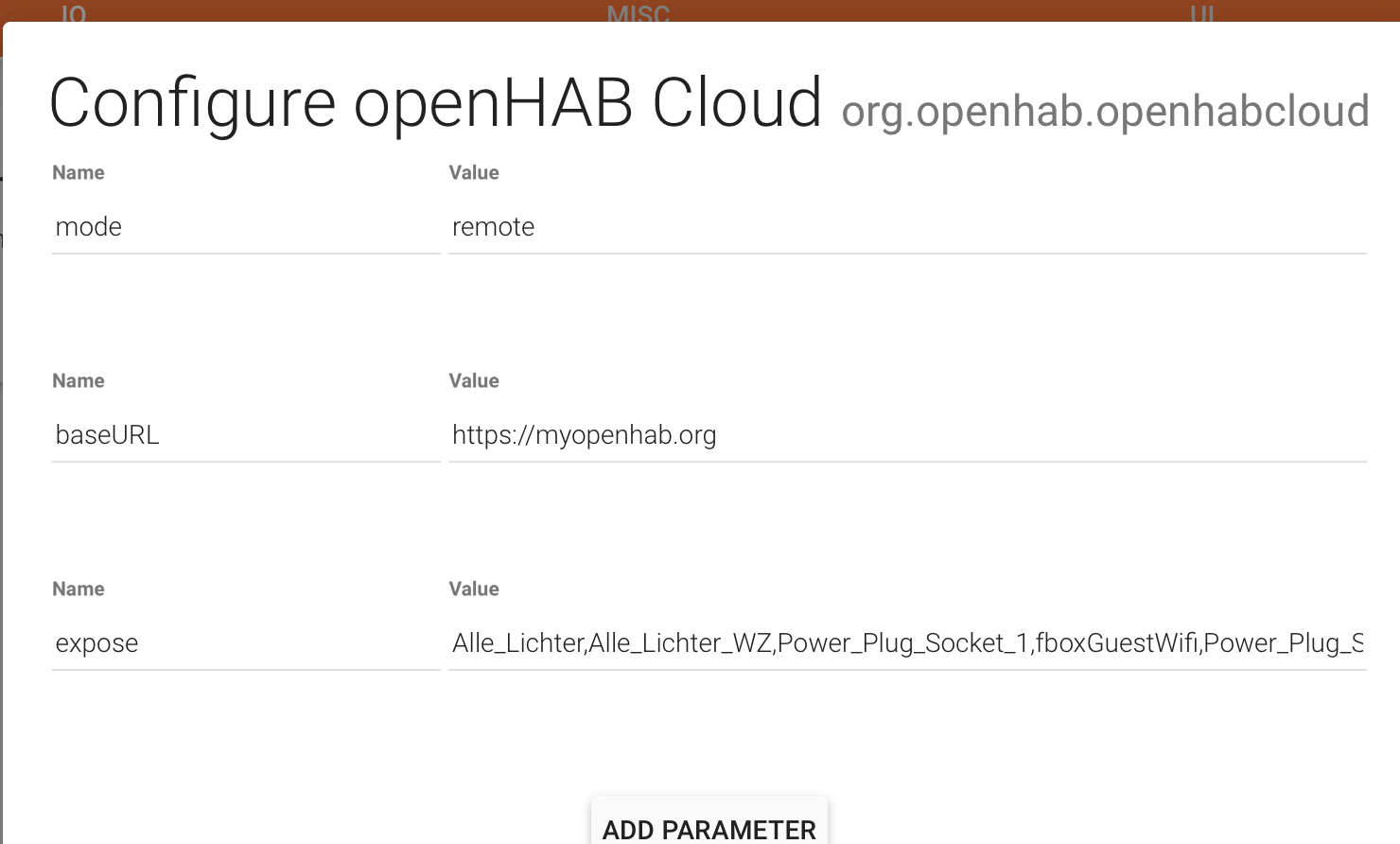

  2. I added items to the config
    but not all of them are shown in myopenhab, even after using these items. Any hints why they are not shown in myopenhab? Interesting point is, that they are discovered by Alexa Skill?
