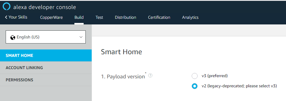

Can you confirm that you are using Payload V2 in your alexa skill?
This should be possible. Read Version 3 (V3) Item mapping section over here https://github.com/openhab/openhab-alexa/tree/v3
@anjana55 , Yes it is version 2.
