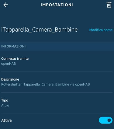

I’ve update my items file but now I see like that:
and no “interactive” image like switchable or dimmer or blinds…

I’ve just tried to say “alexa chiudi la tapparella del soggiorno” or “alexa close the living room blind” but alexa said the this function is not available

Daniele, I think this feature is not implemented yet.
Jeshab’s example is a spoiler of a next implementation
