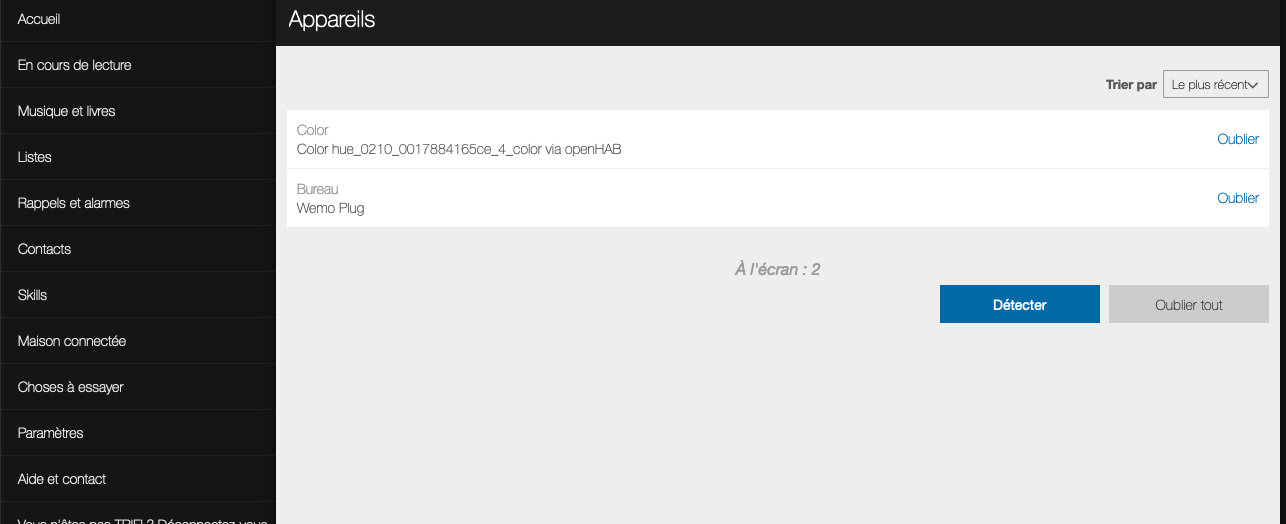

i have a raspberry pi with openhab 2.14. i have installed the skill and the connector but when i scan for item i found nothing.
My item with
// RF Socket Items
Group:Switch:OR(OFF, ON) Gplugs <poweroutlet>
Switch Power_Plug_Socket_1 <poweroutlet>  (Gplugs) [ "Switchable" ]
Switch Power_Plug_Socket_2 <poweroutlet>  (Gplugs) [ "Switchable" ]
Switch Power_Plug_Socket_3 <poweroutlet>  (Gplugs) [ "Switchable" ]
Switch Power_Plug_Socket_4 <poweroutlet>  (Gplugs) [ "Switchable" ]
String PlaceHolder ""
Switch Remote_Send      { channel="exec:command:remote-send:run"    }
String Remote_Send_Args { channel="exec:command:remote-send:input"  }
String Remote_Send_Out  { channel="exec:command:remote-send:output" }

Somebody can help me please?
Your item definitions are missing labels. You can refer to these recommendations on how to name them.
Many thanks i must have read a bad doc where you have only to write
[ “Switchable” ] in your item files :confused:
