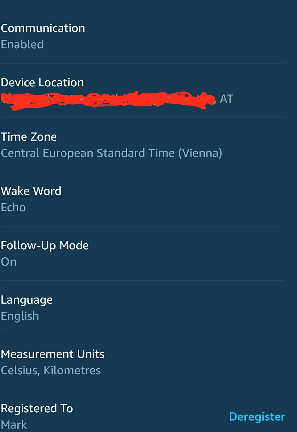

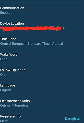

For all my Echos, Show:
Language = English
Device location = AT
Time zone = CEST
Alexa App on phone
Time zone = CEST
No language specified for the App but phone is Austrian with Austrian SIM and language is English
Where did you get that information from? The Alexa app gives the ability to specify the language/country on a per Echo device basis. The only possible countries for the English language on the Alexa side are Australia, Canada, India, United Kingdom and United States. It may have been set automatically when you initially registered your devices, probably based on your phone language settings.

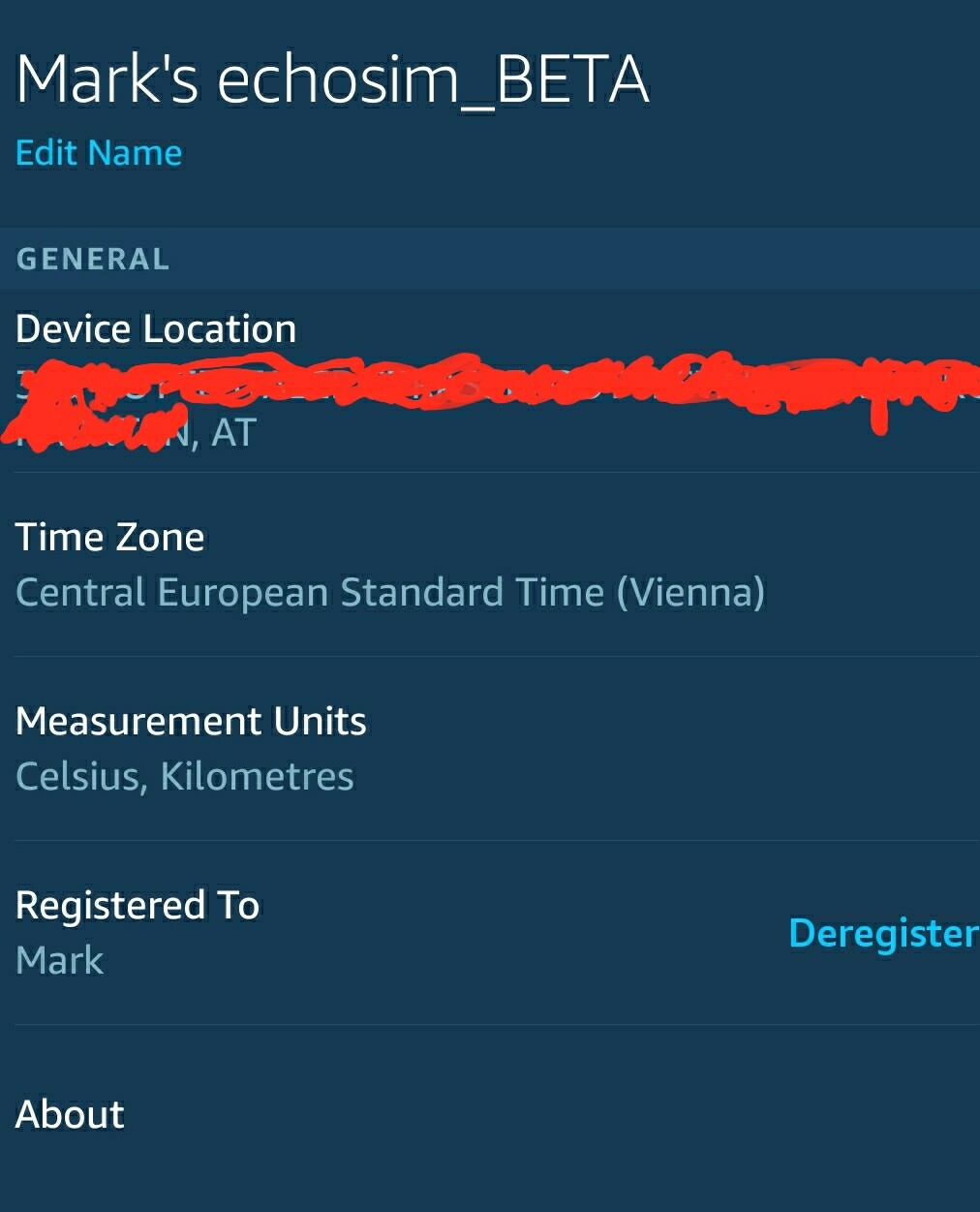

When I first got an Echo I had to call Amazon support for help with the language settings. At that time they had me add a EchoSim to fix the issues. Its still one of my devices but it doesn’t do anything. I was afraid to deactivate in case I ran into Language country issues again.
You can access the Echo simulation tool here for testing Alexa. Probably you know it already:

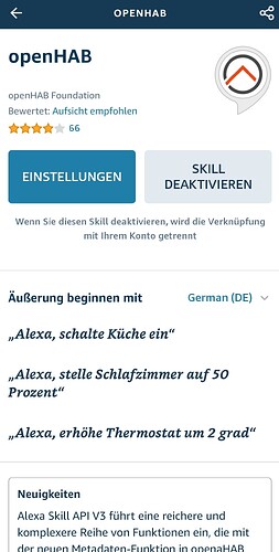

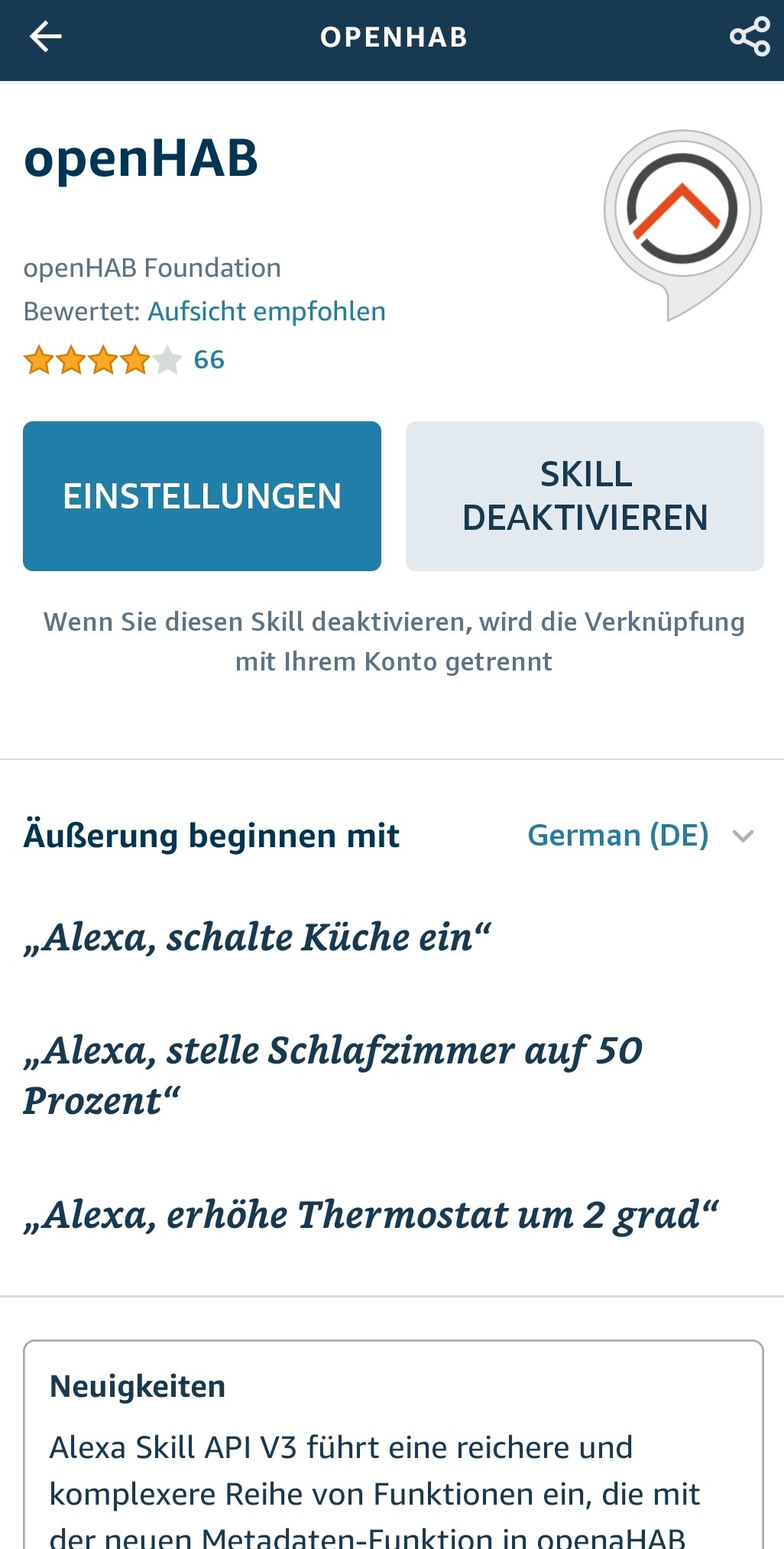

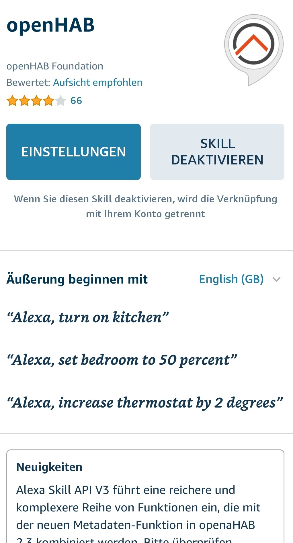

I still notice that my Alexa skills are usually German despite everything else being set to English.!
Even if I change the skill to English it doesn’t keep the setting but it never affected anything before.
