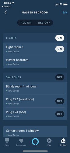

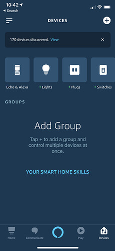

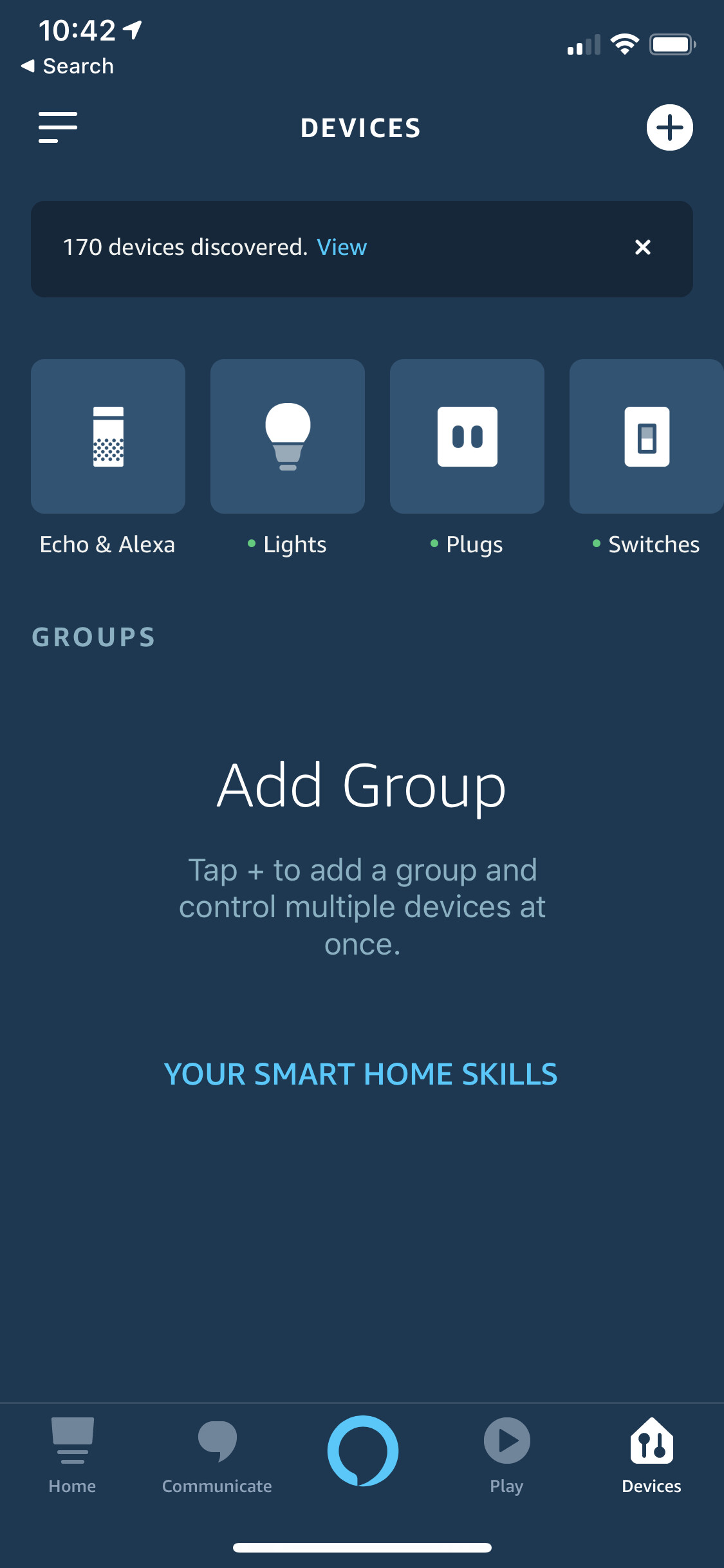

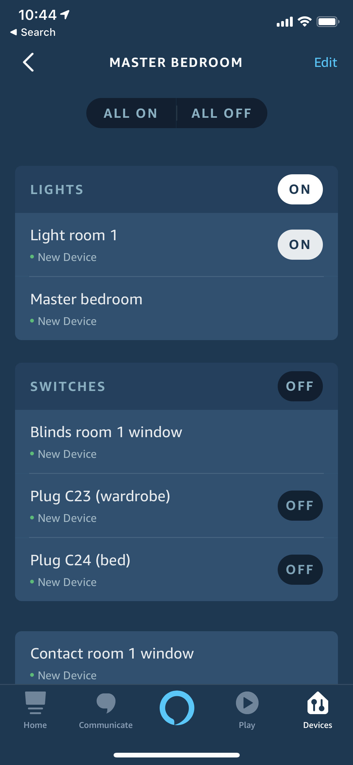

Is there a way to auto-create Alexa groups (not categories like plugs, lights, …) according to the OpenHAB groups?
I want to achieve that it will sync the rooms from OH to Alexa and as such having a living group matching the group in OH allowing to switch on/off lights and/or plugs all simultaneously. As far as I understand the current doc there seems to be no possibility for this or am I wrong?
See screenshots:
Thanks,
David

You can’t auto-create Alexa groups but you can have openHAB groups modeled as a device. You just need to make sure to define a group type on that item.
In the example below, all 4 items will be modeled as a device on the Alexa side. If you request “Alexa, turn off all lights”, all the lights associated to the group will be turned off. Likewise, you can control each light individually; “Alexa, set color light to blue”
Group:Switch:OR(ON,OFF) Lights "All Lights" {alexa="Lightning"}
Switch SwitchLight "Switch Light" (Lights) {alexa="Lightning"}
Dimmer DimmerLight "Dimmer Light" (Lights) {alexa="Lightning"}
Color ColorLight "Color Light" (Lights) {alexa="Lightning"}
It important to note that if you are looking to take advantage of the Alexa-enabled group feature (aka room awareness), you will have to use Alexa groups. There is no way around it.
