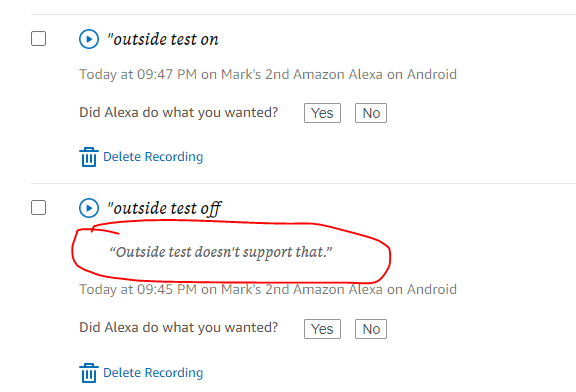

Can I replace
Switch NorthPIRLights_Switch "Outside test" <light>  ["Lighting"] {channel="openwebnet:bus_on_off_switch:Screen10:22:switch"}
with
Switch NorthPIRLights_Switch "Outside test" <light> {alexa="ToggleController.toggleState" [category="LIGHT", friendlyNames="Switch"], channel="openwebnet:bus_on_off_switch:Screen10:22:switch"}
I want to create a Group with a mode controller and a toggle controller but the toggle controller part isn’t working for me. I get ‘…doesn’t support that’ when asking saying 'Outside Test OFF, or ON
You have to use the friendly name you defined, otherwise modeled your item as PowerController if you only have one switch in your group. “Alexa, turn on outside test switch” or “Alexa, outside test switch off”.
I think Amazon implemented this on purpose so you can mix PowerController and ToggleController for specific device ON/OFF settings. So the main turn on/off request would be controlling the power and when using the component name, it would control the toggle items.
I am struggling to get a feel for this stuff at the moment and got a curious response with this item definition
Used as a single item
Switch NorthPIRLights_Switch "Outside test" <light> {alexa="ToggleController.toggleState" [category="LIGHT", friendlyNames="Outside test"], channel="openwebnet:bus_on_off_switch:Screen10:22:switch"}
Which produces this:
As you suggested power controller works both as a standalone item and in a group endpoint
Switch NorthPIRLights_Switch "Outside test" <light> {alexa="PowerController.powerState" [category="LIGHT", friendlyNames="Outside test"], channel="openwebnet:bus_on_off_switch:Screen10:22:switch"}
Thanks again Jeremy.. Now my idea is working…
