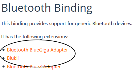

I have a hard time to get along with the official and even “featured” bluetooth binding:
The documentation says that it offers support for the Blue Giga Adapter and Blukii devices:
Unfortunately I cannot connect to my Blue Giga Adapter with the binding. When I look at the supported things in PaperUI I cannot find the Blue Giga Adapter:

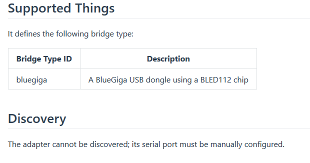

The documentation for the section Blue Giga says that it cannot be discovered, but that the serial port needs to be set manually:
However, WHERE in the world can I set the serial port for the Adapter? And how can I add it at all?

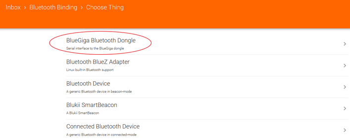

I found a workaround to get the bluegiga stick to work with the official bluetooth binding (at least a little bit as it still does not work really reliable).
The problem is that if you install the offical Bluetooth Binding via PaperUIn then OH will install all parts of the Bluetooth Binding (like BlueZ, Blukii) except the BlueGiga-Binding:
grafik
My workaround is to use the Addon-jar-File where the BlueGiga-Binding is included and drop this manually in the Addon-Folder. After this we can see in Karaf Console that the BlueGiga-Binding has been added:
grafik
However you will additionally have to install the Serial Binding in order to get the BlueGiga-Stick as an option. After installation of the Serial Binding you now can add the BlueGiga as a new thing:

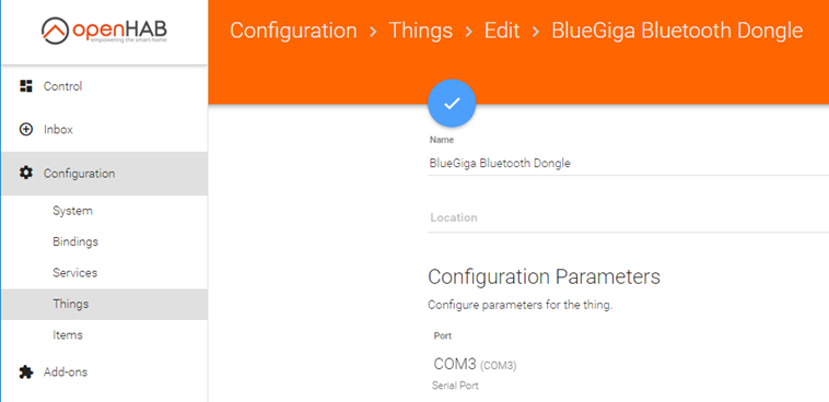

esh-binding-bluetooth-bluegiga              │ 0.11.0.SNAPSHOT  │ x        │ Started     │ openhab-addons-2.5.0-SNAPSHOT        │
In PaperUI, then I was able to add and configure the Bluegiga adapter:
