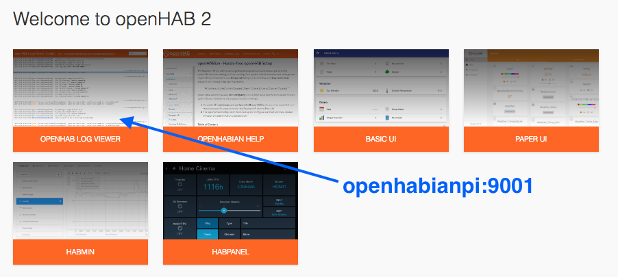

can i change the link from this icon:
the link goes to: openhabianpi:9001
it should be: openhabianpi.local:9001 or with ip:9001
thanks

ubuntu:
/etc/openhab2/services/dashboard.cfg
thanks that helped ![]()
frontail.link-name=openHAB Log Viewer
frontail.link-url=http://openHABianPi.local:9001
boot solutions
and
:9001
doesn’t work
This site can’t be reached
openhabianpi.local refused to connect.
Search Google for openhabian local 9001
ERR_CONNECTION_REFUSED
any ideas?
It’s openhabian 2.1, installed ist the expert mode on a raspberry 3.
Thx
Peter
are you on windows ?
try the Raspberry IP instead of the .local adress
something like:
192.168.0.100:9001
I’m using a raspi 3 and with the IP address it doesn’t work too? ![]()
