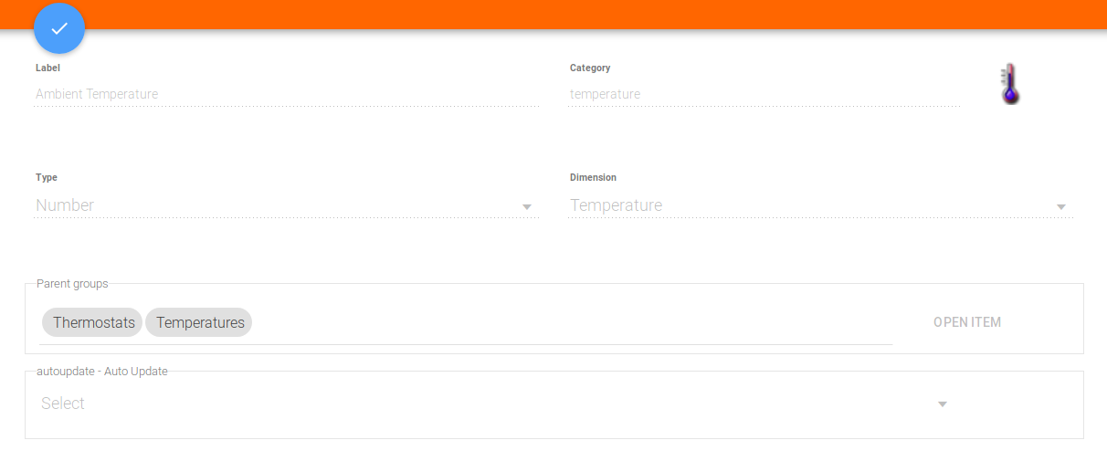

In the Label field:
Mine are greyed out because I defined the item in text files

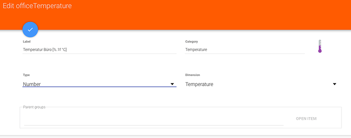

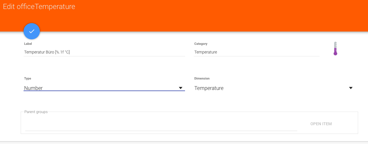

this I tried already yesterday, but it doesn’t work.
This is the item definition:

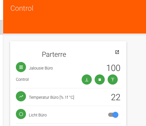

And this is the result in the Control of the PaperUI:
The paperUI is for admin purposes only.
You will need to create a sitemap or use HABPanel.
