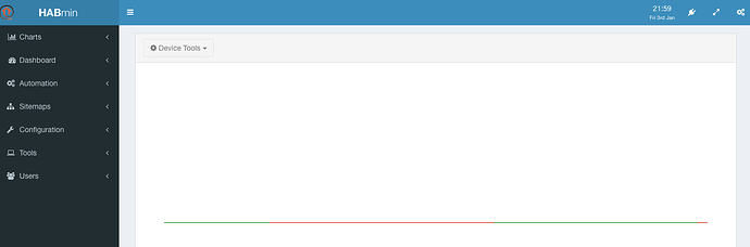

I am experiencing a strange problem with the Habmin Z-Wave Network Viewer, which just produces a fine horizontal line, but no structured network mesh anymore. See attached Screenshot
Screenshot 2020-01-03 at 21.59.32
Is there any cache or something that got corrupted and needs resetting ?
I am running OH 2.5, but I had the same problem today before I updated from OH 2.4, so the update did not fix it. I am running on RP3, with an Aeotec Z-Stick Gen5 plus > 30 nodes.
Thanks for your help and happy new year, Markus
That will only display after a full network heal that is normally scheduled for 2AM. Has that run yet?

not yet with OH 2.5, I just did the migration today. I’ll see if this gets fixed tonight and report back.

no luck, there is no network view after tonights zwave heal. Any hints on what I could try ?

You can clean the OH cache using:
sudo systemctl stop openhab2
sudo openhab-cli clean-cache
sudo systemctl start openhab2
Yes, tried that (found it in another topic), but did not help. Does somebody know where Habmin stores its data ?
Thanks, M.
HABmin doesn’t store any data. It reads this from the things…
How are you configuring your system? Are you using text files or PaperUI?
Finally I got a network display again. I probably was restarting the system too often while developing. So it seems it needs a bit do the heal successfully.
