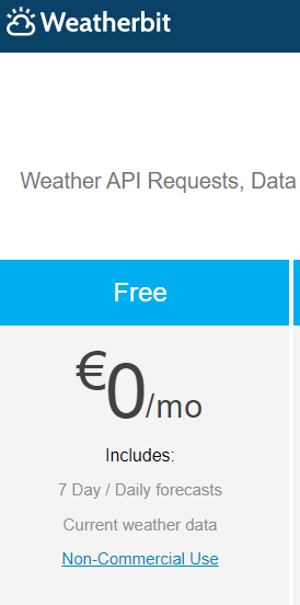

I’ve tried the Weatherbit Api:
It is running again! :grinning:
I just noticed today that my forecast Items did not get updted for week.
Even though I new this would happened. :sweat_smile:
Thanks @Celaeno1 for pointing me in the right direction to solve this.
For everybody else how wants to know what to do (and how easy it is):
  1. Create an account at https://www.weatherbit.io/
  2. Wait 15-30 minutes until your API key is activated/provisioned.
  3. Edit your services\weather.cfg
    3.1. Delete apikey.ForecastIo=xxxxx
    3.2 Add apikey.Weatherbit=xxxx
    3.3 change location.home2.provider=ForecastIo tp location.home2.provider=Weatherbit
    3.4 Set location.home2.updateInterval=30 or higher, because the free APi only allows 50 calls per day
The rest of your configuration can be left untouched.
The values or your existing items should be updated automatically the next time the bindig calls the weather service.
