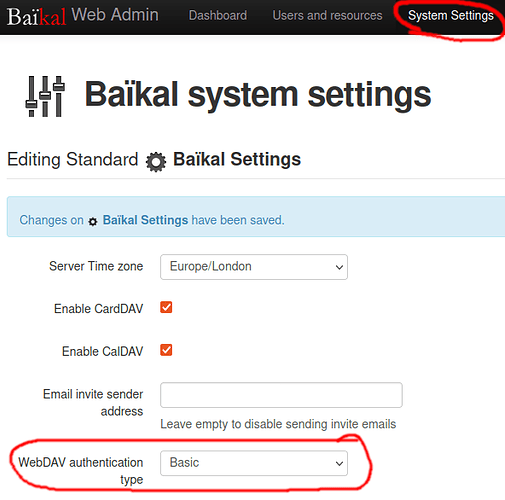

Solved it. I had to change the caldav authorization to basic. Not really sure what I am doing here but as the calendar is only accessible locally I think I will survivie
#define(“BAIKAL_DAV_AUTH_TYPE”, ‘Digest’);
define(“BAIKAL_DAV_AUTH_TYPE”, ‘Basic’);
Where did you put this line? I notice you mention using Docker, but that doesn’t look like anything from a docker-compose file.
