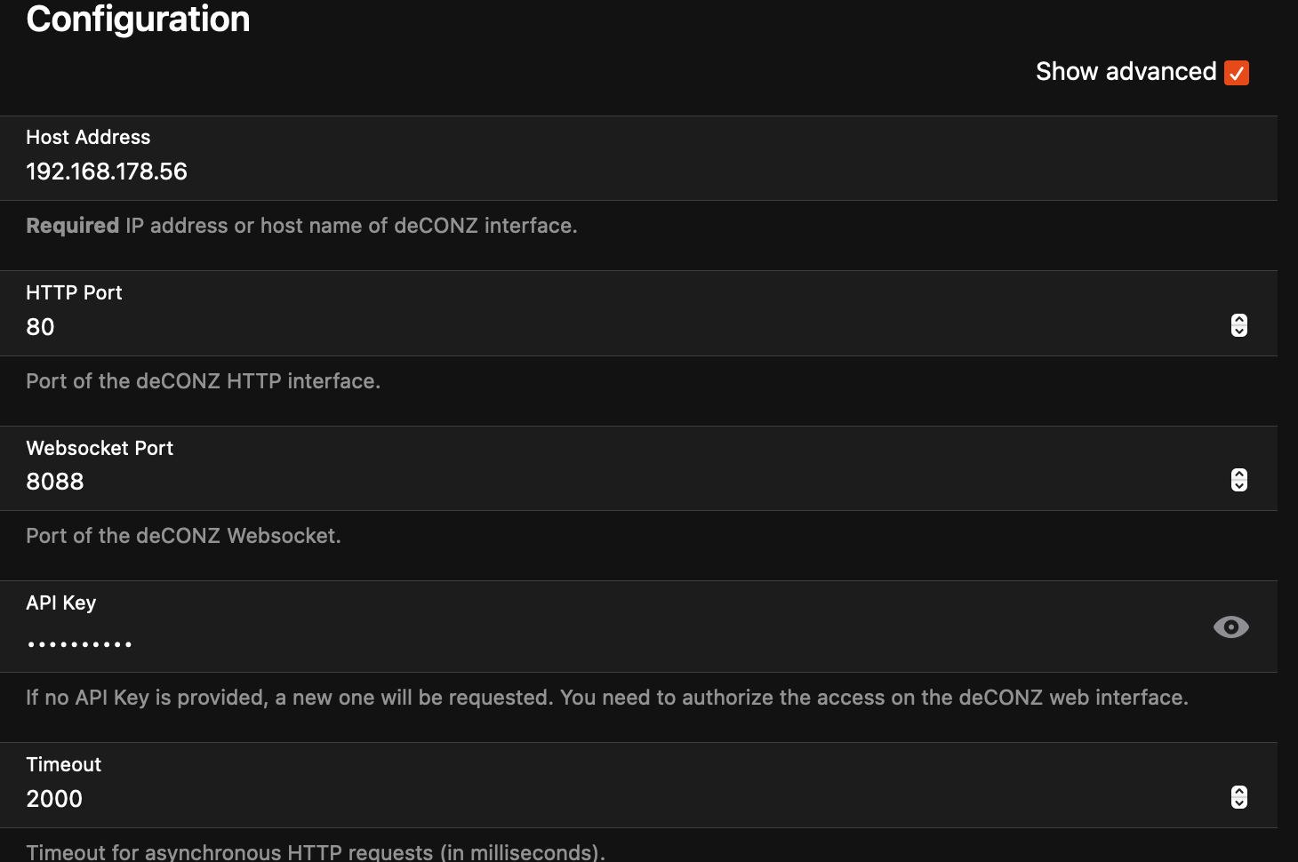

It seems like OH uses port 80 instead of the defined 8088?
The full state is requeted from the HTTP port as it uses the REST API, not the websocket. The websocket (and the port) is only used for receiving events.
If you moved the REST-API to another port, you need to change the HTTP port, not the websocket port.
