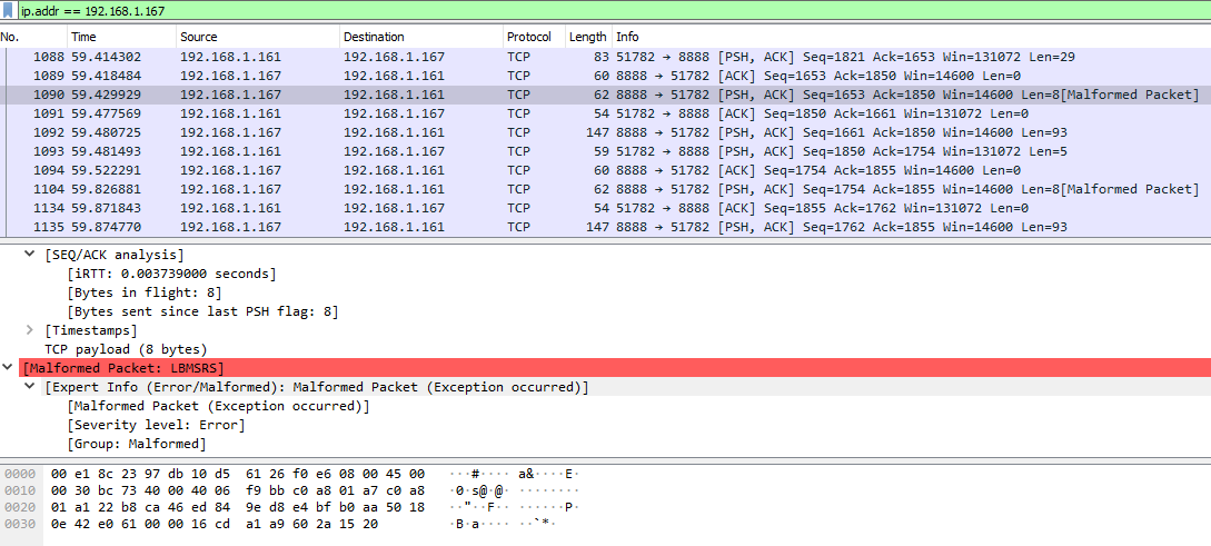

@chris
What can I do/can be done to find the root cause?
