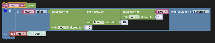

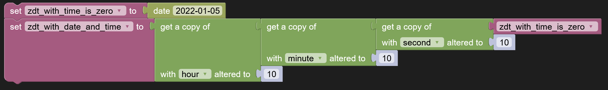

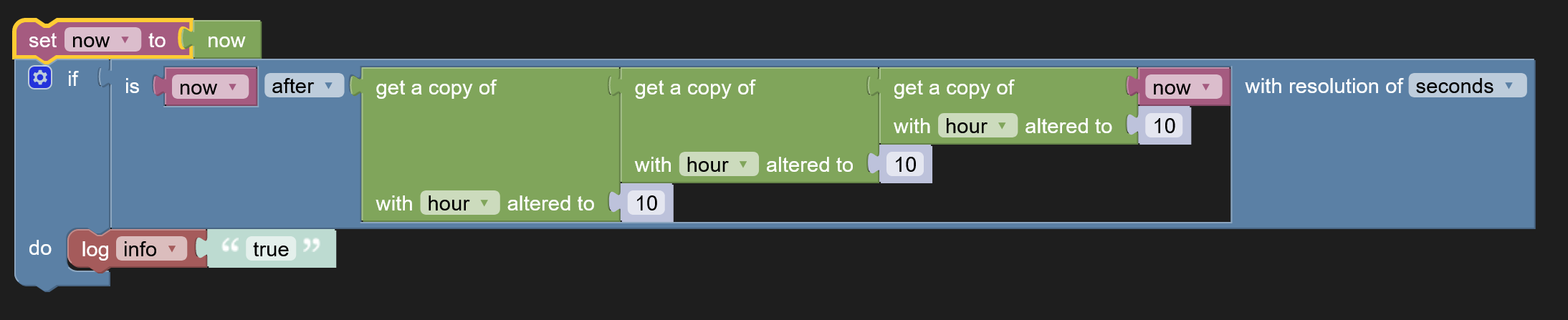

I’m also in the process to convert my rules to Blockly. I created a custom library which operates on ZonedDateTime.
https://github.com/deibich/oh-custom-block-libraries
Just copy the content of libraries/datetime/library.yml
In the main ui go to developer tools → block libraries → add a new library paste the content and save.
To set a time you need to alter the ZonedDateTime object.
The compare block compares two ZonedDateTimes. To compare two time values you have to set the dates of the objects to the same value.
